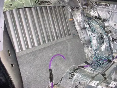

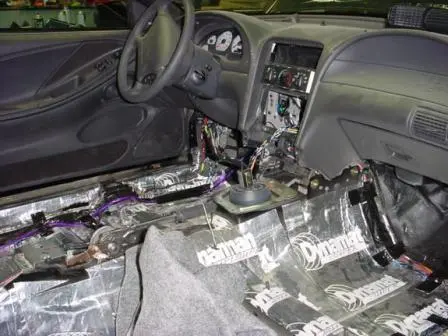

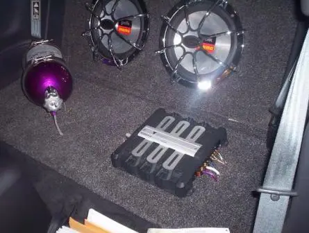

Removed the back seat to install sub's, amp, and oh yeah NOS!!!!! Used Peda-ply wood, and Speaker fabric...650watt Polk Audio 12"s, Kenwood KAC 1000watt amp, Alpine CD player, Alpine Digital Equalizer/mini-disc player...used existing factory Mach 1000 6x9's, replaced door speakers and tweaters with Polk Audio. I went with a Zex 75-150 Shot Wet System. After careful consideration I figured Zex was the most userfriendly considering I do everything my self. Just to be safe I installed a venom control module in the back ground as a failsafe.
With my current set up it takes me about 23 seconds to hit 160 from a 15 mph roll, I was having to much rpm drop when I hit 6th gear and actually loosing a few mph on the shift so I figure the NOS will make up for the lack of torque on the top end and get me to 180 or 190 pretty quick.
Feel free to comment.

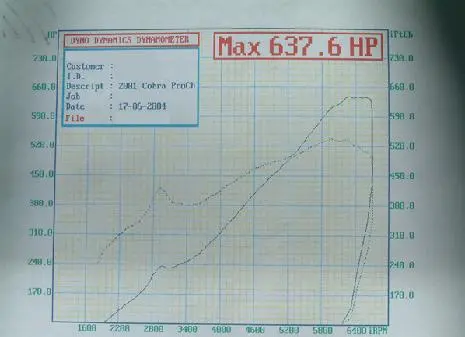

I had it dyno here at a place called Mustang Xtreme...

So, 9:1 compression, cams, a KB....and now nitrous.
That 600+RWHP number is whith the nitrous right?
What kind of boost are you running?
Intercooled?
What size Nitrous shot?
What is your fuel system, injectors, MAF?
What octance gas are you running?
What's your timing set at?
Fill in your sig so we know what you are running.
The pistons are rated at 8.75-9.0:1 N/A, With the Blower at 9psi its probably more like 10.5:1 or better. With NOS...I couldnt tell you....
Piston kit was designed for a high boost/NOS set up.
Intercooled kit with after market throttle body/90mm MAF sensor, etc.
Timing is at 18 degree's.
Its a 150 shot...im using the largest nozzels I could fit for that kit...which are not even zex :nice: I snagged from a buddy off his 200 NX kit...Zex doesnt make anything bigger than a 125 kit for my set up. Im running the injectors the S/C kit came with...42lb.
No the dyno doesnt include NOS. That would be cheating... :nice:
Roatating assemble is internaly balanced with the factory forged crank, Eagle H-beams, and JE Alum lightwieght pistons, Kenne bell 9psi intercooled kit(Came with cold air kit and 90mm MAF senor), patriot stage 3 heads (Patriot mills some serious heads at a resonable price), comp cams 2000-6200 rpm cams, BBK 65mm Tbody, 3:55 gears, Diablo Programmer, Zex 150 shot, Venom Control Module, JBA Shorty headers, MAC off-road H-pipe, Flowmaster 2 chambers, Steeda G-Track (Subframe connectors, 1.5 Springs, caster camber plates, All upgraded bushings on balljoints, etc.; sway bars, stabilizers, adjustable upper control arms, lower control arms and trailing arms, bilstein shocks and struts, bump steer kit, Cobra R Ties rod ends, Cobra R brake conversion, Brembo brake controler, Hays Comp Borg and Beck Pressure plate w/ a super connector sprung hub organic clutch disc...and well thats all I can remember for now...custom rollcage soon to come...need to save up about 3000 grand for the custom work...which is going to come through the fire wall and connect directly with the frame and suspension...includes a Cobra R hood for strut tower brace clearance...the brace will interconnect with the rollcage, frame reinforcement assembly. .

Numbers seem high for only 9lbs of KB boost....even with all the supporting mods. I've been reading where most 99-01 Cobra guys are not happy with their KB's because they are only getting low 400 to the wheels. Granted that is just with exhaust mods and the KB.
I'm pushing 14 lbs of boost through my Vortech and have many additional mods. I'm at 21 degrees timing and hitting 532RWHP. I'm running the 03 Cobra injectors (flow rated at 43 lbs per hour) and pretty much at the limit of the injector. If you are pushing 600+ RWHP you will want to upgrade to the 60 lb injectors.
Not accusing, just curious as to why your numbers are so high when others are low.

I think he was joking when he said the dyno #'s were on boost alone. :nice: By the way, that is a sick ride. :cheers:
I have worked with several timing settings...18 degrees got me my best over all power from 2000 - 6000 keeping some decent low end torque and still allowing the motor to work up in the high rpm's where it's set up to work. Anything past 20 degree actually caused me to loose power...and I noticed engine knocking even with vp fuel.

I hate doing this, but I gotta call BS on this one.
Why does your graph stop at 6300RPM? Your car should be able to spin to 7000-7500 RPM's. Did you run out of fuel or something?
Also, that is unlike ANY KB dyno graph I've ever seen. KB's are known for bringing on the power at low RPM levels, yet your graph looks just like my centrifical blower (where power goes up with RPM).
Every other 99-01 Cobra that has added a KB is in the low 400's, yet you make 600+ at 9PSI. I have a friend with a 99 that added the KB (no intercooler), makes 8PSI and is pushing 400RWHP.
Sorry, it just doesn't add up. That dyno chart is what really makes me call BS. NO roots or twinscrew blower would ever make a curve like that. Also, I believe your torque numbers are way lower than your HP numbers....hmmmmm???? :notnice:
Ya, this stuff just doesn't add up.
630RWHP and only 125mph in the traps? OK, I could see if you had no traction, but you had a 1.4 60ft time, so you had traction. I assume you are pulling the front tires off the ground then. With the power you state you have you should be pushing 130+ mph in the traps.

Not starting nothing, just pointing out that that graph isn't yours....no way. No roots or twin screw blower would ever put out a torque curve like that.
The pictures you posted do look nice. But your power claims are a pipe dream.

Torque curve is not right for a blower motor. It should come on strong at low RPM and stay rather flat through the range. Something isnt right.
