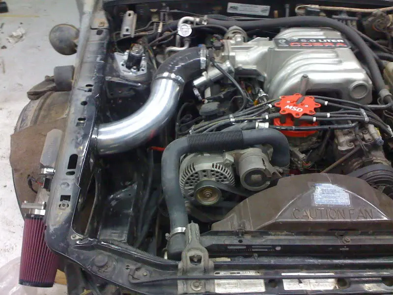

i said in my other thread that i was making my own power pipe because i couldn't see spending $185+shipping for a piece of tubing and some rubber elbows. well i finished it today, aside from putting a filter on the end of it, but i have a K&N cone filter coming in the mail. it's a 3.5" pipe.
cost of supplies:
mandrel bent 3.5" aluminum tube = $42
two 3.5" black silicone 90* elbows = $48.97
K&N cone filter = $21.24
total cost = $112.21
i saved myself a good $70 - $80 piecing together my own setup and it looks just as good, if not better, imo.
i modeled it off of the afm 3.5" N/A pipe AF-0104c, but mine doesnt have as sharp of a bend, and i put my MAF sensor in the fender with the filter...
first, here's the afm for comparison:
here's mine:
what do you guys think? :D

Did you bend the tube yourself, or did you buy it preformed from a supplier?

thanks a ton for the compliments. Yeah I'll post up demensions and such when I get home, I'm on my iPhone right now. No I didn't bend the pipe myself. I got it on eBay, 2' in length pre-bent to 90*. There is a company on there that sells all pre-bent intercooler piping bent to different angles. I picked up that 90* piece for $42 shipped. It's a nice piece too, about 4mm thick. Anyways, I didn't really have to do any work, just bought all the parts and pieced it together. Only thing I had to do was cut the pipe down on both sides because it was too long.

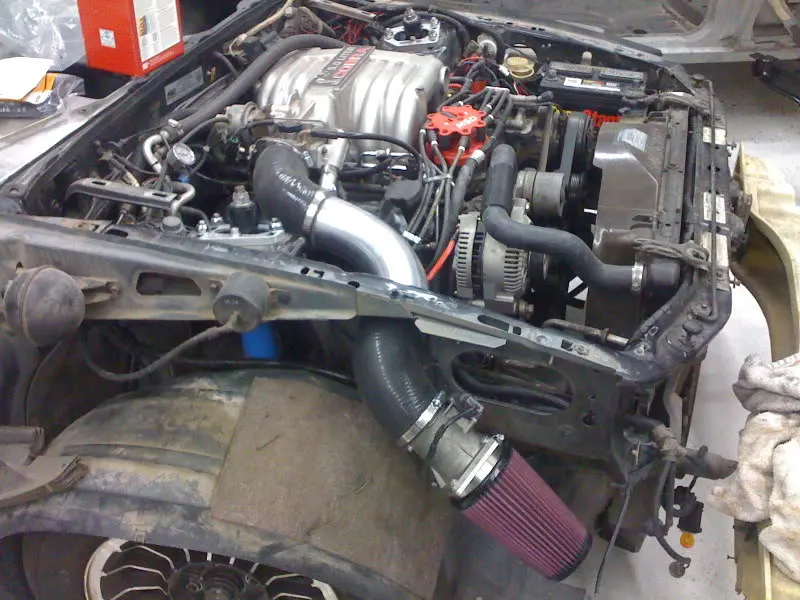

here's a few more pics with the filter on. you can't see in the pics, but i also did a little bit of wire hiding as well. i took the pics before i did this though. there are no more wires in view on the passenger side except behind the strut tower where the big harness is. on the driver's side i hid as much wiring as i could without relocating the coil or solenoid. so there's still some wires right there, but it's a lot better than it was. you can see i wiped up the area where the air box was. :D that's all i've done as far as cleaning up in there and all i did was get a towel wet and wipe it a bit. looks a ton better already!
