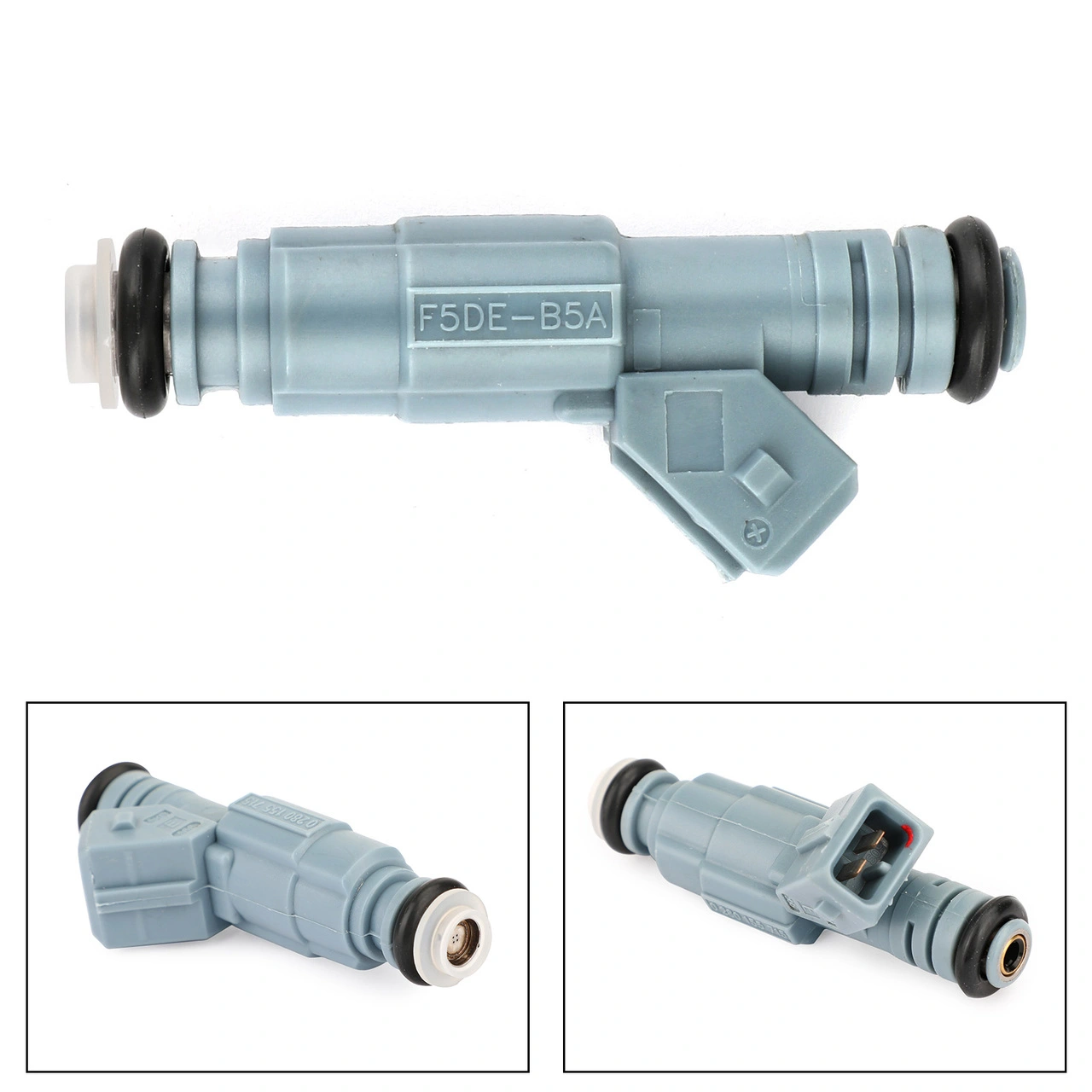

I am getting a gauge with the BBK FPR however I have no idea where I should set the pressure with either injectors. I was going to do 4 hole with either style but to be clear I am able to run the attached style?
Yep, those are the thin body EV1's :nice:
