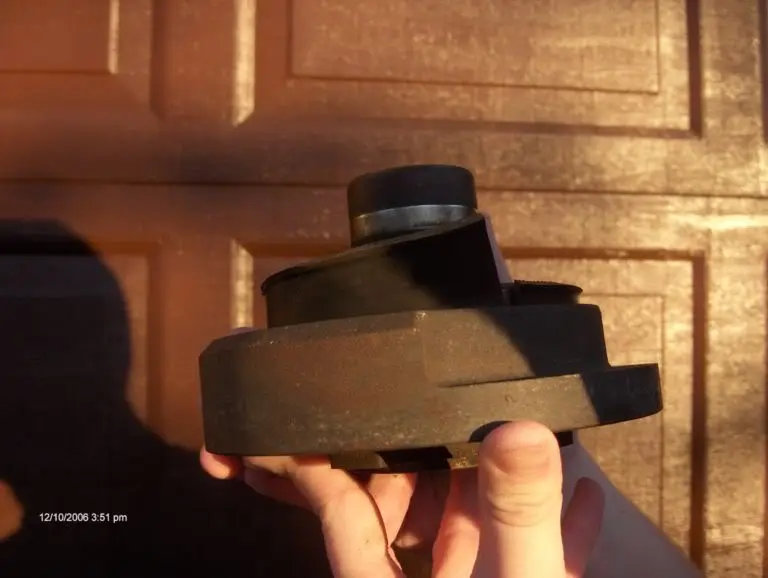

Check your Harmonic Balancers Kids!
I used to go through a balancer every year. I don't think they stock ones liked the RPM. I was replacing mine with old used ones and that could have been part of my problem also. I swapped to an Aftermarked one and haven't had any problems since.
Good to see you caught this before it came clear apart! :nice:
Couldn't even guess the amount of threads like this one have come across
here over the years :crazy:
Yes ... higher rpm's can kill the OEM hb :Word:
I lost mine :(
after some high rpm datalogging working on my WOT fuel ratio
Grady
wuts a good brand aftermarket one to go with?
If you wanna go to a really nice SFI hb
I have been real happy with my Pioneer pn 872030 :banana:
No install hassles like with Romac :nono:
No spacer needed also :D
A quality part for sure :nice:
I been running one since early 2003 with no probs :)
and
I spin it up to just a bit more than 6K on occasions too ;)
Grady
AFAIK, even non-fluid SFI balancers use an elastomer. They tend to have a better build-quality (better method of elastomer introduction - not press fit). The rings are indexed and even secured together with additional means.
There still should be an elastomer in there though.
and
Grady
x2 - when I went 331 my builder included a balancer in the engine build. It's not a Pioneer and I wish I had one like I did on my 302. I had to use a spacer on the one I have now. :( The spacer is rated as high as the balancer, so what's the point. :nonono:
weaksauce son!
