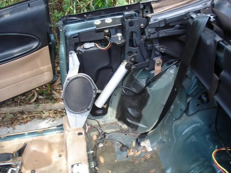

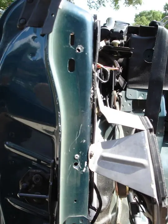

i have a 1994 gt vert. how do i mount the brackets on the car? i understand based on the instructions that i rivet the bracket on the inside of the B piller with the nuts facing the rear of the car? the picture in the instructions shows the light bar between the bracket and the B piller. what gives? please help!

The lightbar goes between the b pillar and panel, the bracket goes like you said. Im not sure how the cutoff switch gets spliced in it should come with instructions.
Also you have to move one of the speaker brackets,and when you put the lightbar in put one side in about an inch then pull on the other to get it in. Put masking tape around the area you have top cut so you don't scratch up the panel.
