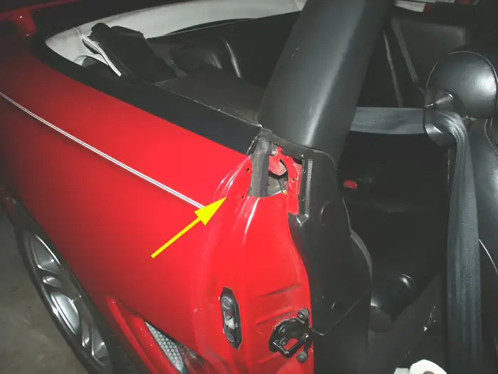

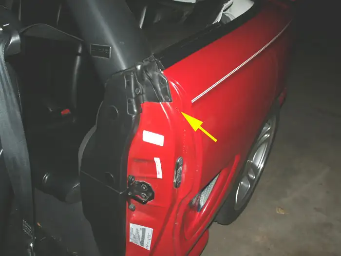

Here's some pictures from something unrelated but you can see my rivet plugs...
The arrows in the first two pictures are not pointing to anything related to the lightbar. That's something different. But if you look at the panels, you'll see two plugs on each side that are where your rivets are going to go.
