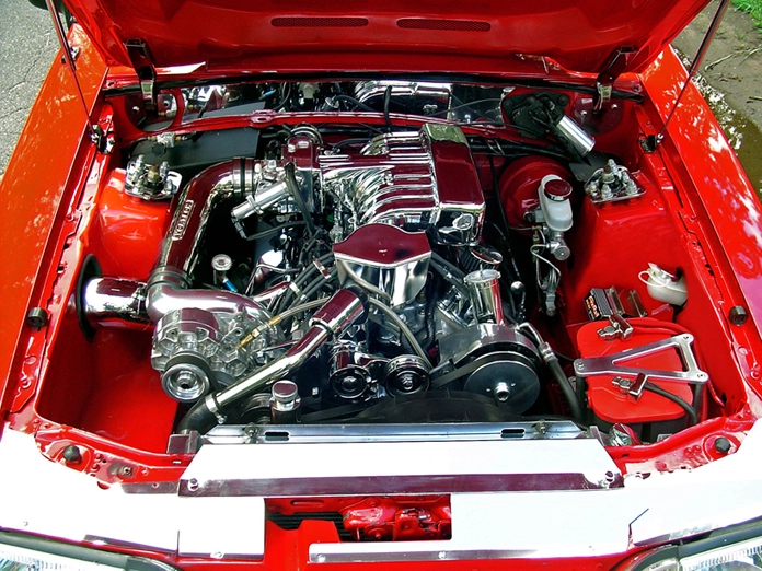

Another item to note is vacuum lines. I've removed a/c, smog, EGR, and cruise - so I don't need the vacuum tree anymore. Also, my evap canister is gone (and I park the car in an attached garage and never smell gas!) so the only vacuum lines I have are a 3/8" line from manifold to brake booster, and a 1/8" line to the FPR.
pic.php
Listen to guys like mansonzz - he was one of my inspirations.
