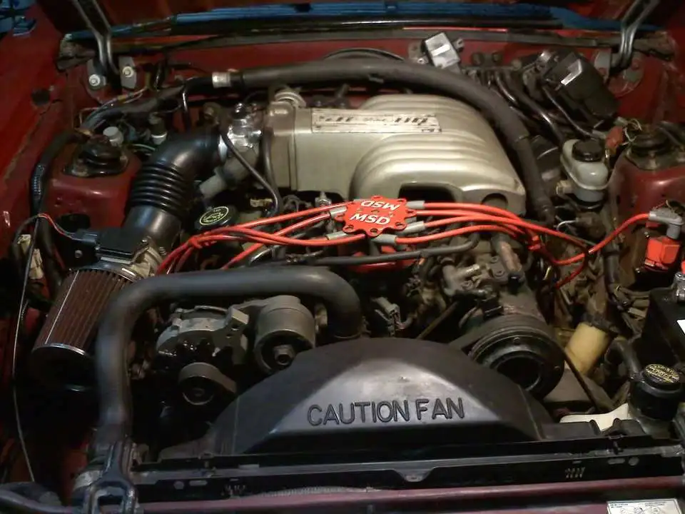

cleaned and buffed the car alittle i think it came out pretty good havent got a chace to get pictures of the whole car because im stuck in all this stupid rain that has been going on since sunday but this is what i got
cleaned up the motor a bit and the new throttle body is on still needs alot more cleaning but this was without degreaser so i think it came out ok

That looks really good man! Post up what you used and how you did it. I'm interested in doing this to my car.

i actually got the supplies from my work, but everything is from AUTOMAGIC i first compounded it with "Power Cut Plus" with a medium cut yellow foam buffing pad that was also purchased off the AUTOMAGIC truck. Then i hit it with xp pollish with a finnishing blue foam pad. Then new car glaze with ultra fine finnish buffing pad. i think the car could of came out alot better if i used more products and more time but i was just happy to get all the oxidation off here is the site where you can find the same products
AutoMagic® Products
just click on what you want to look at on the the left of the screen

man that's impressive, what a difference!

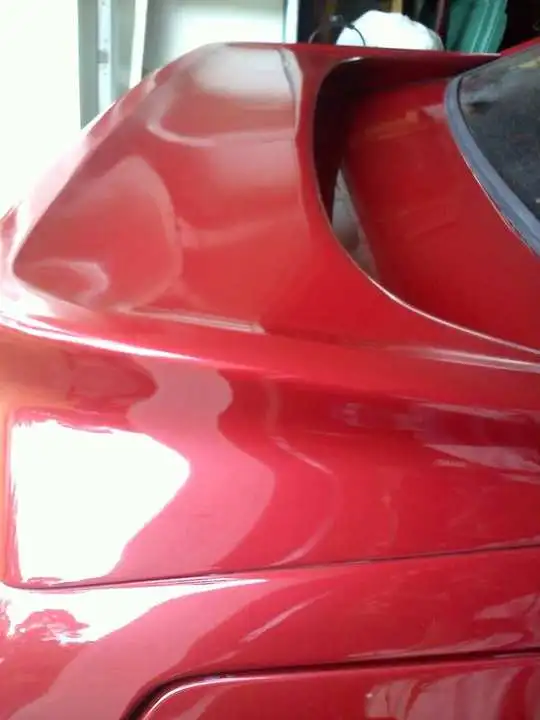

i also for got i used xp swirl remover with a 3M foam polishing pad

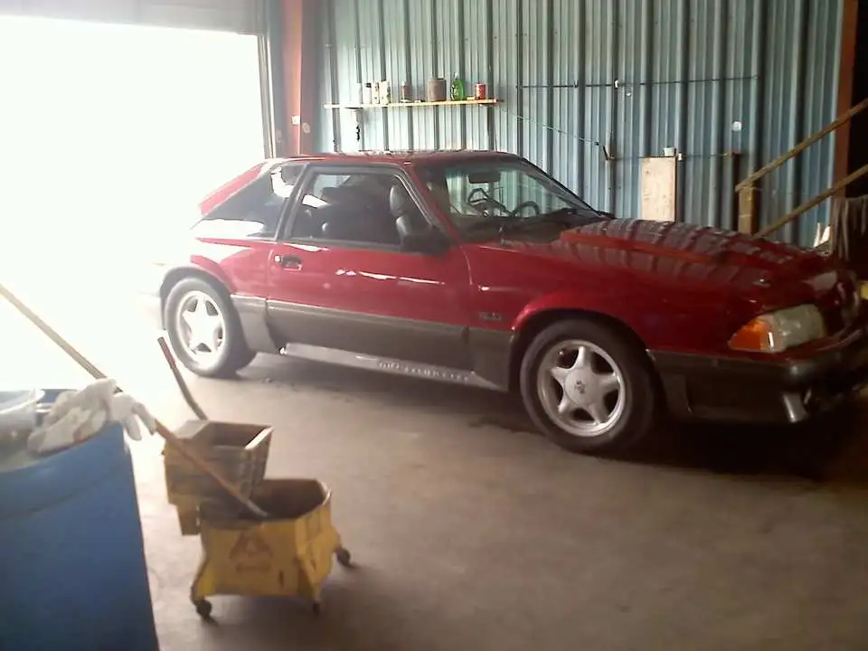

ok here is some more pictures finally had a sunny day still had a few swirls so i put it in my bay at work and did some swirl removing
back bumper needs paint chipping pretty bad at the bottom
dont know why but my wheels look white in this pic weird
