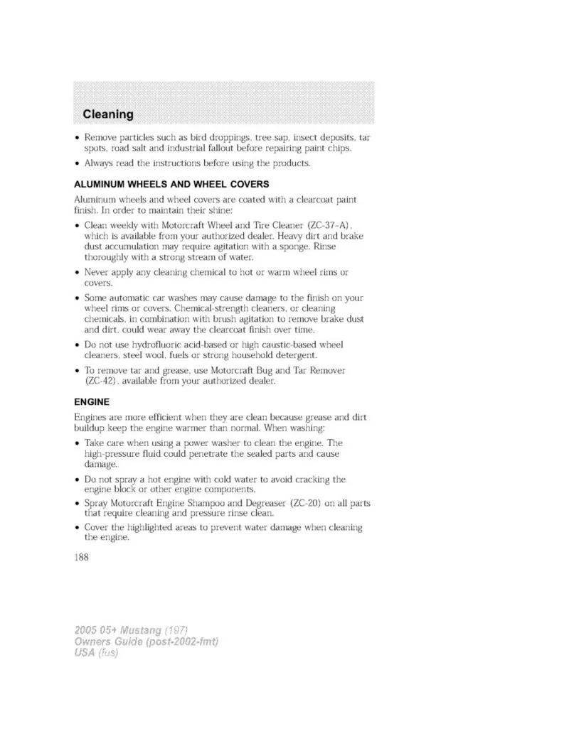

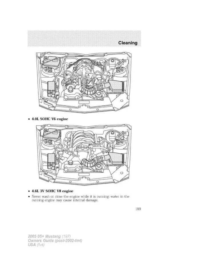

I found this in the owners manual on how to clean your engine. If it was unsafe why would ford give instructions on how to do general keep up on our cars.
