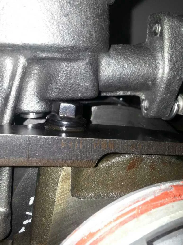

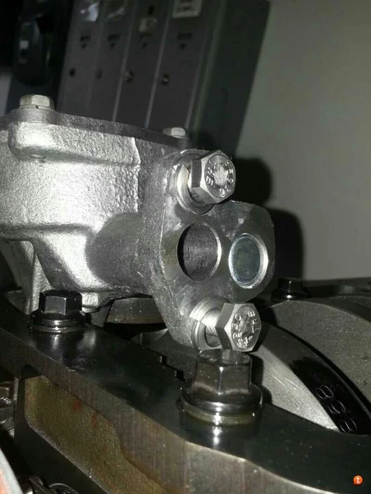

Dusten Hammond New Member Feb 14, 2012 8 0 2 Mar 23, 2014 #1 Mar 23, 2014 #1 While attempting to install a hi flow oil pump I noticed it's hitting my girdle on my 347. Would it be safe to grind down my pump a tad? How much room do I have to grind away? Attached is a couple of pictures for reference
flstang65 10 Year Member Dec 6, 2007 1,484 135 94 SE Georgia Apr 18, 2014 #2 Apr 18, 2014 #2 In this case, less is more. Start on both sides a little tiny bit, reinstall to c heck for clearance, massage some more, reinstall, ect.
flstang65 10 Year Member Dec 6, 2007 1,484 135 94 SE Georgia Apr 18, 2014 #3 Apr 18, 2014 #3 I would focus the majority of my work on the bolt head making sure you can still remove it in the future if need be.
