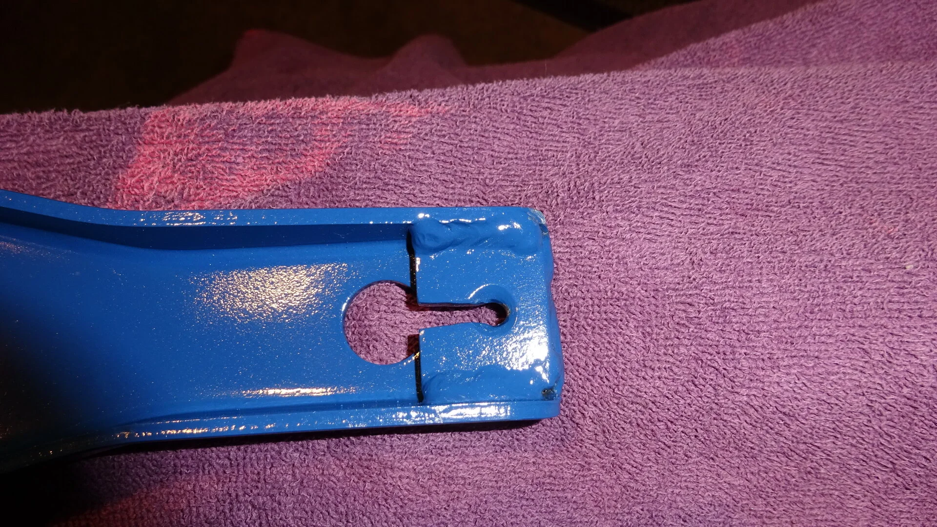

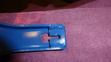

It's a standard 86-93 Fox body T5 arm (two holes like eyes, open channel between them). I finally located some pics of a MII arm and noted the hole and slot. I am now making a piece to weld behind (in the U channel) the arm that has a hole & channel like the MII arm but am also countersinking the end of the channel for the ball with a ball end tool. Darn near ready to install this thing and ran into this when the clutch cable arrived.

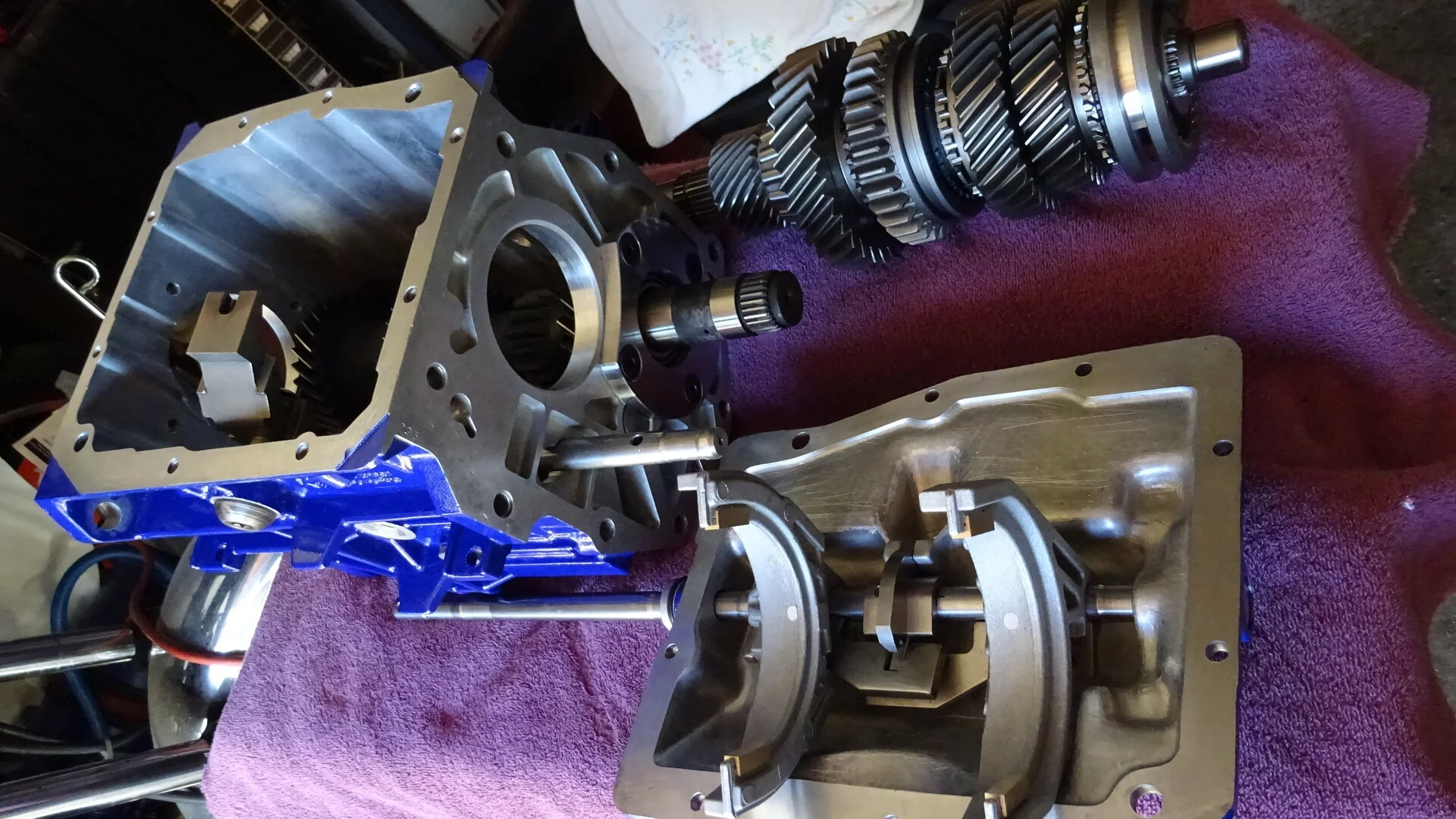

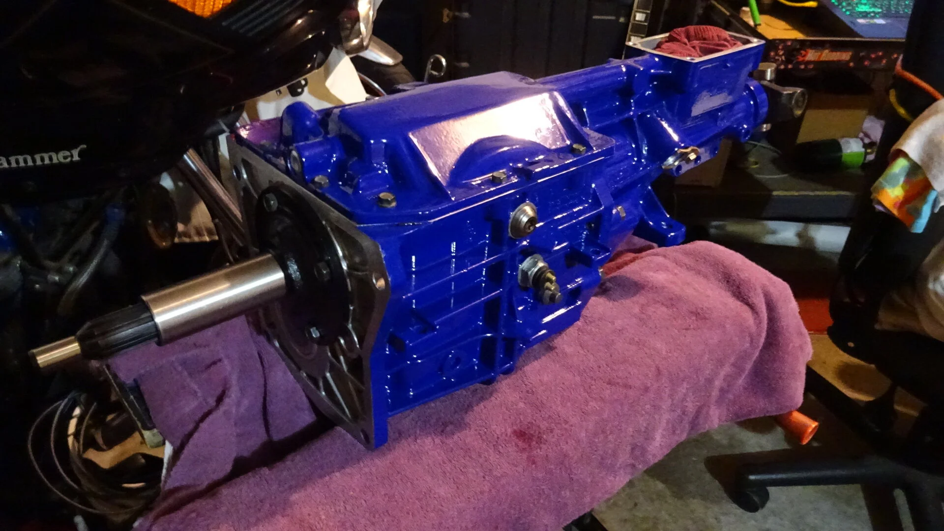

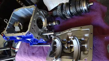

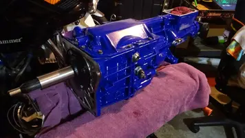

OK, back in action again (work diversion). I cut and welded in a 3/16" piece of steel and it works perfectly! Trans is installed and clutch works nicely. I painted the arm because we live about 400' away from the Pacific Ocean and stuff rots here. I also powdercoated the trans (dark Ford blue) and bellhousing (silver). I'm installing the exhaust system this week and hope to have it back on the road in two weeks. Trans has new Tremec 2.95 gear set and synchros.
