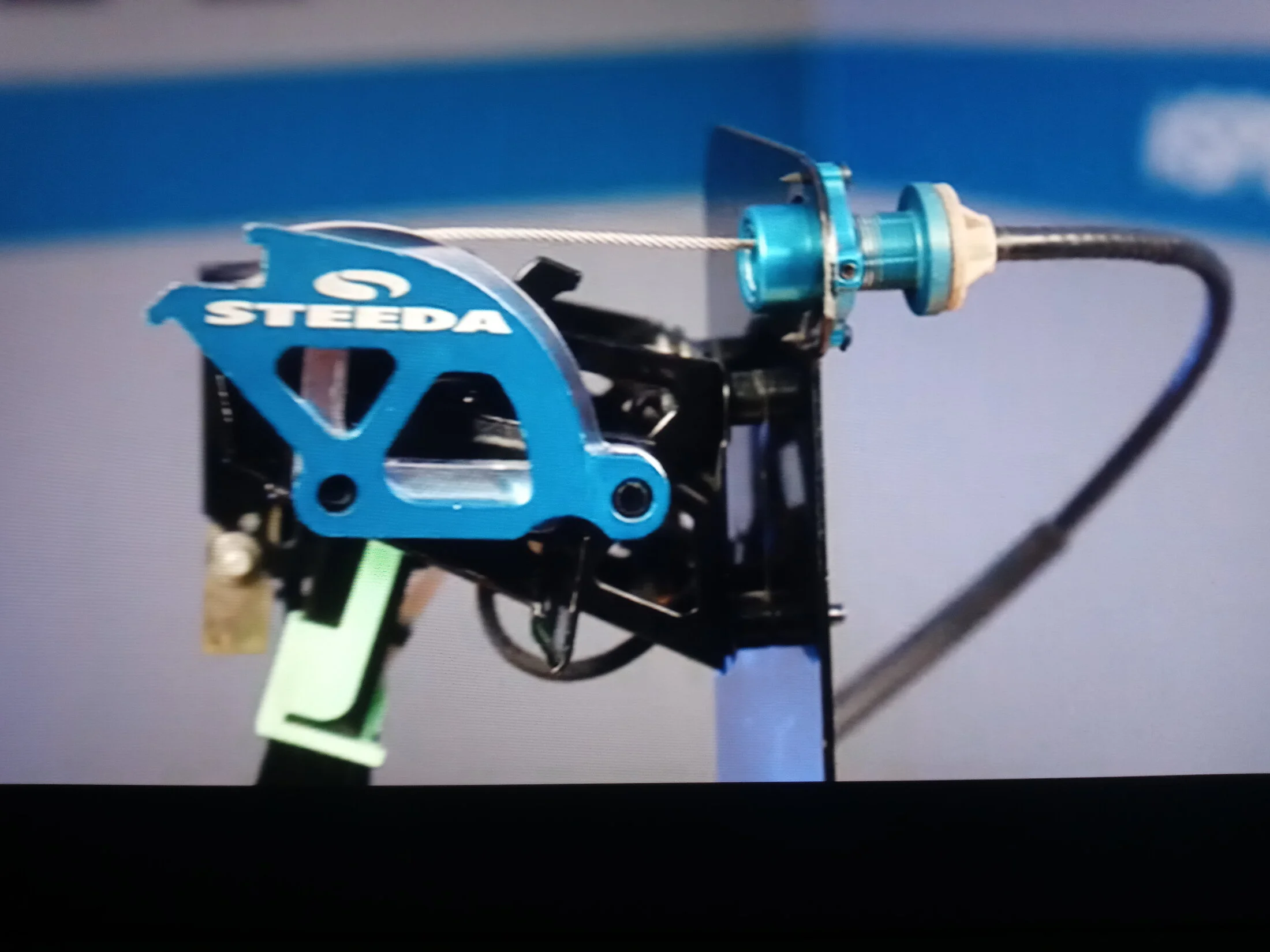

The quadrants can make a difference I’m going to install the Steeda quick release it gives you 20 to 30% more pull...... i’ve seen some good videos on clutch adjustment... if it grinds when you put it in reverse you’re not getting a good release .... your transmission is still engaged .....

Hey ebone is that what a quick release is for? To "disengage" the clutch quicker? I always wanted to know what a quick release quadrant was.. hah
When you say 20 to 30% more pull would that be pulling harder on the cable or would that be the same draw or just a quicker pull so to speak?
One more thing. sorry. per the Steeda quick release and MM quad. Would the steeda quick release be a harder clutch pedal than the MM?

The reason it’s grinding is because the clutch is still ingauged spinning the transmission...... I’ll try to upload a YouTube video explaining it.... steeda Has a good video on their site about the quick release its slightly harder but it gives you more pull.....
