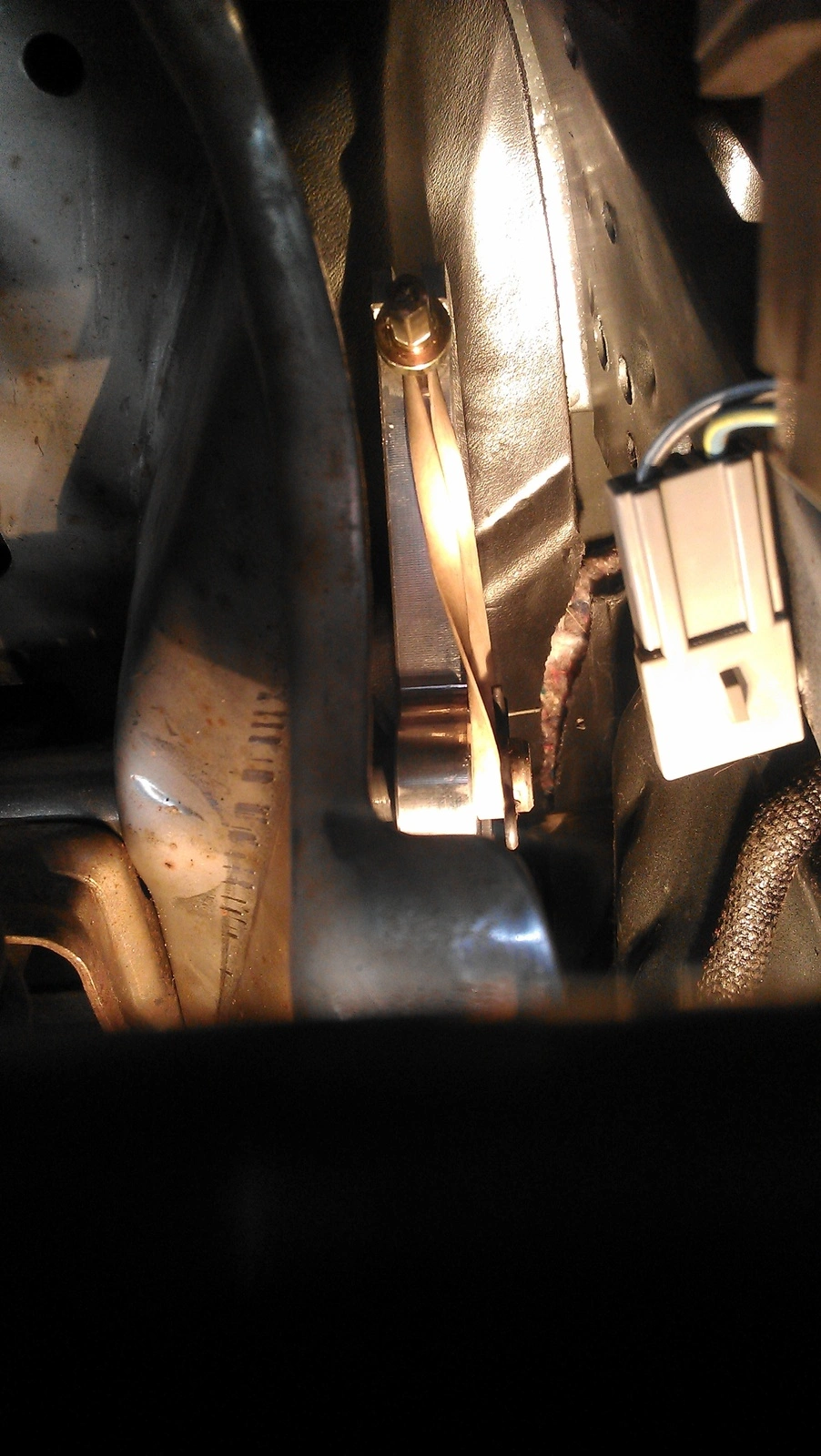

Help for those who have replaced the clutch assembly and are still having problems with adjustment:
The next step doesn't make much sense it you already have the transmission installed, but just for sake of discussion, here it is:
The throwout bearing sits in the clutch fork arm with the wave springs pressing on the rear flange of the throwout bearing.
Major differences between the distance between the flywheel surface and the clutch fingers may require tinkering with the clutch fork pivot ball. Stack your old pressure plate, clutch disc and flywheel up like they were when installed in the car. Tighten down all the pressure plate bolts and measure the distance between the clutch fingertips and the flywheel face.
Too much thickness will cause the clutch fork arm to sit too far back to get the clutch cable on the quadrant. It may even sit against the rear or the bell housing hole for the clutch fork arm. In that case, reduce the pivot ball height.
Too little thickness will cause the clutch fork arm to sit too far forward and bottom out against the front side of the bell housing hole for the clutch fork arm.. This will prevent the clutch from fully disengaging.
In other words, the clutch fork arm should sit positioned midway or a little towards the rear in the bell housing hole for the clutch fork arm when the cable is properly tensioned.[/url]
