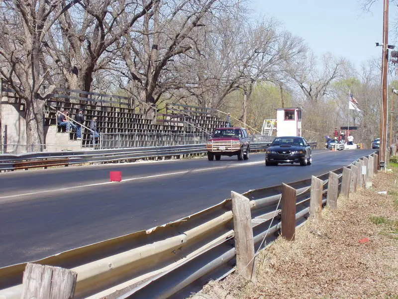

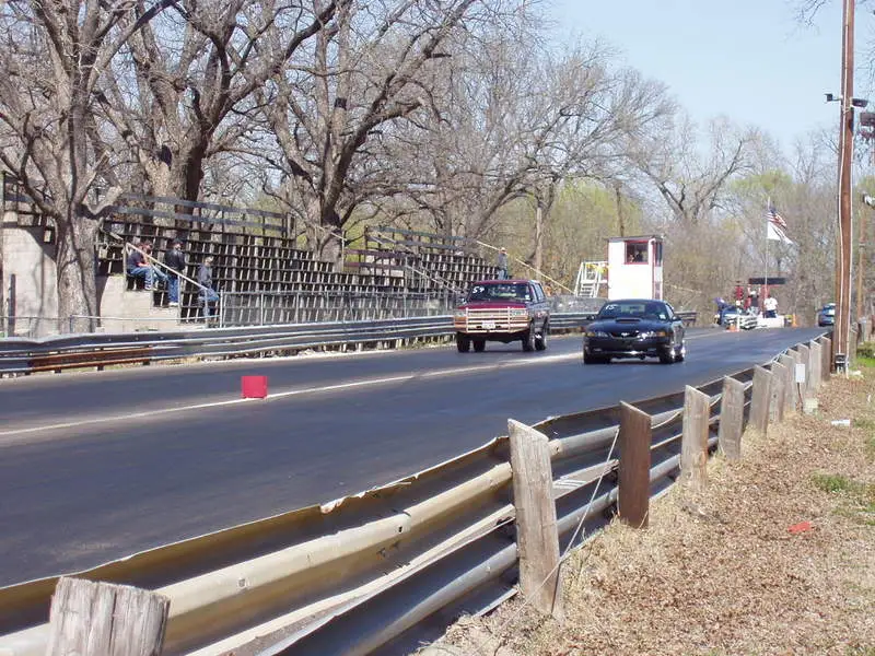

Sorry to ruin your happy moment but nope (especially with your trap speeds :jester: ).... I only aborted 2 runs, one was against a 04 White GT and the other was against this Bronco but I was so far ahead anyways I still netted a better ET:
