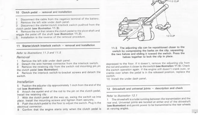

Ok, my neutral safety switch came undone a while back. So, i just reattached it. I push the pedal down as hard as i can with 2 hands to see if it touches the little white grooved tab at the end... it doesnt. Is it possible that when i tightened the neutral switch down, it needed to be aligned a bit and moved forward so it touches? any ideas???
Oh, my problem was that the car wont start. new battery, selinoid. cables. when i turn over the car... nothing. wont turn over. just to let you know where im at. Will start if selinoid is crossed.
ignition switch is my next option.
You can try adjusting the white clip thing. It will make a ratcheting sound, and it will self adjust the first time you press in the clutch. You can also try jumpering the switch to make sure it is the switch.
good responses. on mine, i could set it wherever, and after driving, where i bottomed the pedal, i would have to really bury the pedal to start it. really disconcerting.
this might help ya
Nate,
Mine was doing the same thing. I adjusted the clip and it works fine now. A friend's was acting up intermittantly, and it was the switch.
I believe there are just two wires into the switch. Just run a wire between them and try to start the car. The switch just completes a circuit allowing the starter to engage. Of course, make sure it is in neutral first!

I can hear you saying, "Oh, I'd never do that". Yeah, right. Make sure you are talking for your girlfriend/wife/neighbor/uncle/dad/mom/yada/yada. Take a few minutes and fix the thing, then you won't have to worry about it. It's a self-adjusting mechanism, you just have to push it back through so that it resets. Crawl under there and check it out! :nice:
