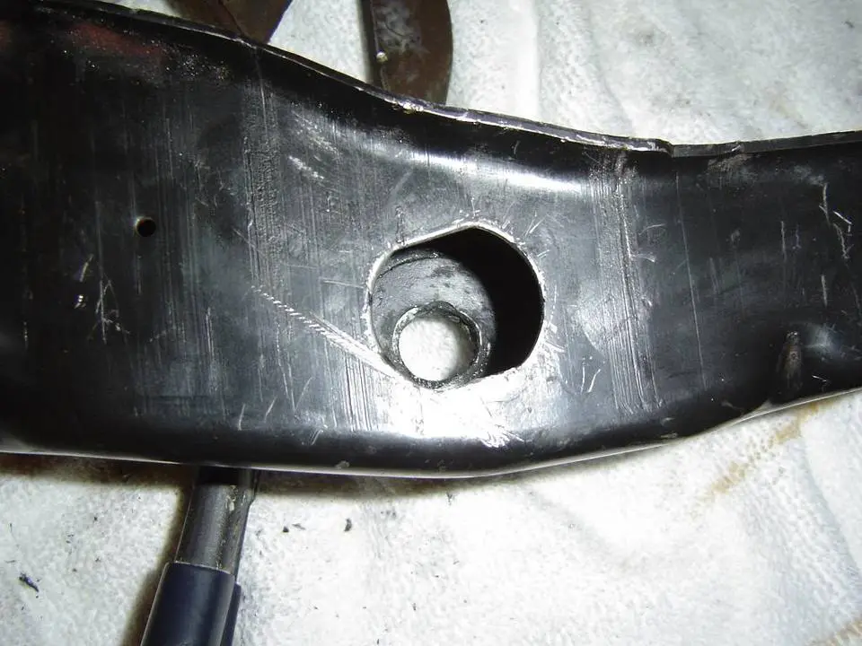

My holes in the support are oblong from the factory. They are clean cut out, and not from wear on the bushings. The bushings fit in perfectly and were oblong from wear, BUT the support hole cut for the bushings are oblong as well, from the factory. There are 2 flat edges on the holes, making a sort of oval shape.
When I put the roller bearing in there, its allowed to slop around side to side... I'm beginning to think my support is somehow different. You can see the old potmetal bushing on the other side still in.

hmm..thats very strange..ok, few things to look at here
1. did you order the correct roller bearing kit for the correct year?
2. Are you sure the opening is oblong shaped from the factory, its hard to tell from the opening shown, is the other opening with the potmetal busing oblong as well?
3. We might need another opinion on this one? If all else faild, ill crawl under and take a look at mine..its been a long time since i did the install and cant remember if the hole was circular shaped or oblong....

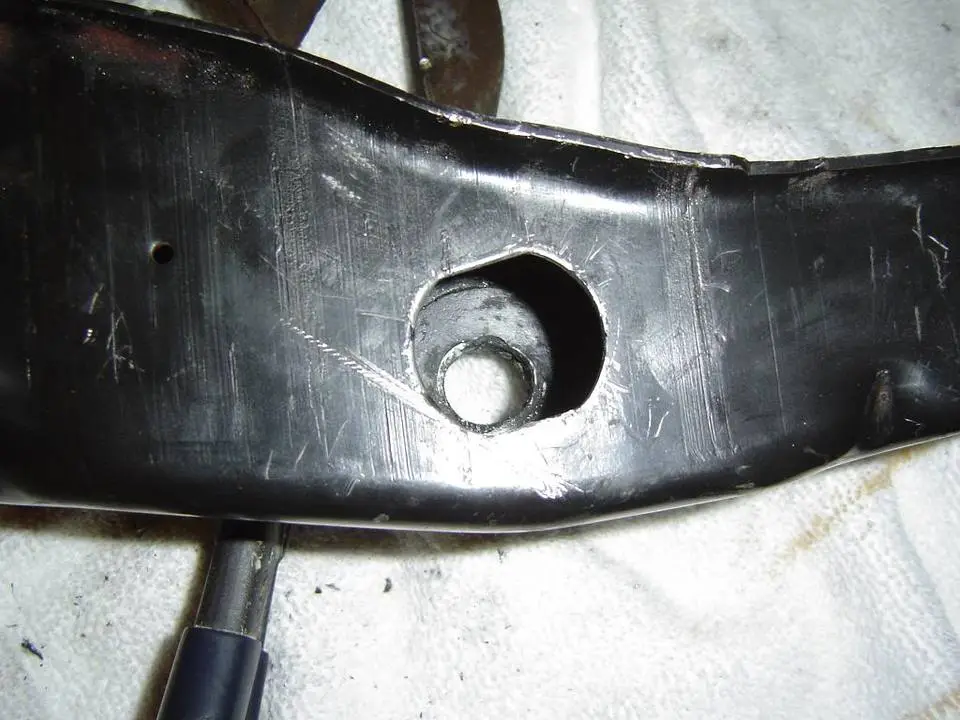

I wanted that pic to show...lets try again. Also, it might be factory for another vehicle...falcon??? I believe the factory Mustang support was not painted, but bare metal.
<img src="http://home.pacbell.net/lorax1/support.jpg">

thats a much better pic than mine....in my car, mine was just like the one shown, circular..so carbine, you might have a different part, or its just worn to some weird perfect shape lol :rlaugh:
My trans is a 3 speed from a fairlane... maybe the owner transfered over the 3 speed and pedals as well?
Funny thing is the car was a factory 3 speed, and I can't see ford putting in a fairlane trans and pedal support.... The roller bearing sits in fine, its just the oblong shape lets it slide back and forth. Worst case I'll just put something in the empty space to keep the roller from moving around. Just weird cause the pedal support seems exactly the same as a mustang one, with the oblongness..... makes no real sense. And I got the right parts, and the other bushing has an oblong hole too.
