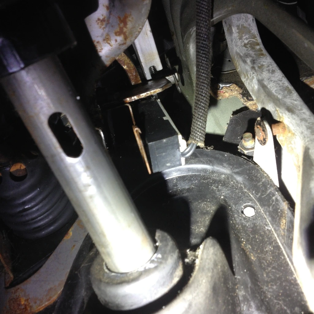

Theres two switches on the clutch mechanism under the dash. One is the starter safety switch. On the other side there's another. What is that one for? Here's a pic
I'm pretty sure the other one is the kill switch for the cruise control.
Hmm. I thought the starter safety switch doubled as the cruise control cut off. The starter safety switch has two harness plugs. I thought one was to control the starter and the other to kill the cruise. Then, there 's this other on on the other side that I'm trying to figure out what it does. I could be wrong
Looking closer at that pic... I have no idea what that is. I don't recall ever seeing a switch like that below the quadrant.
The cruise control vacuum runs to a vacuum switch at the brake pedal.. Cruise control uses the brake switch.
Can you find the wire colors or where it connects to ?
I just did some exploratory test driving.
As you know, the starter safety switch engages when you push the clutch pedal completely to the floor. You can see that it functions that way when you look under there and push the pedal down. This other switch over on the quadrant side is closed when the clutch pedal is in released position. It opens almost immediately when you begin to depress the clutch.
I drove along with cruise set at 50mph. Tapped the brake and the cruise shut off. Reset cruise to 50mph and continued. I slightly depressed the clutch (didnt touch the brake), and the cruise shut off.
Conclusion: The switch pictured does actually shut off the cruise.
Reactions: 90sickfox
The one in the pic is the cruise control dump
The two on the pedal arm are the starter interrupter, and the Nuetral sense circuit
I understand the starter interrupter.
I'm curious, how does the neutral sense circuit play a role in the 5spd application? What about the clutch position has anything to do with the trans being in neutral or not?
I've been learning about these switches because I'm chasing an issue with stalling when I push the clutch in. But I have more info on that (whole other subject) LOL I'll start another thread about that.
No, it's let's the computer know if the trans is in neutral. Technically speaking, clutch down means engine should be coming to idle. Not really clutch position. NGS(neutral gear switch) is the correct term for the switch. As well as the switch on the side of the trans. They work in unison to provide the computer the input for in gear or in neutral.
