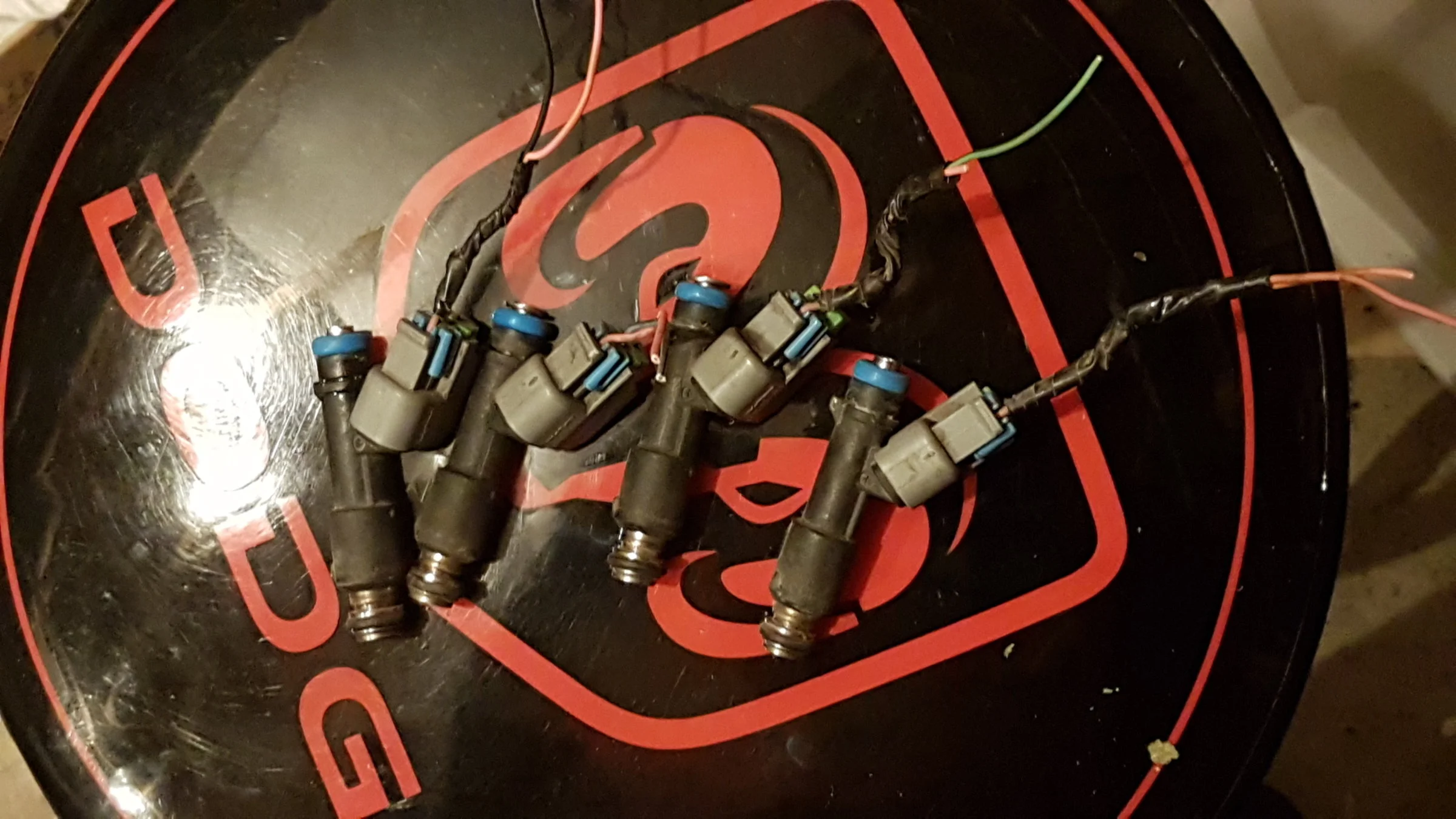

Sorry, they are GM part #12582219
If you know the height of the stock 19's I'll measure these with a caliper.
They should fit, and if their resistance is around 14.4 ohms, should be able to b run with adapters.
Biggest hurdle is there are no Mustang aftermarket MAF for 28# injectors, so you will need a tune to run them.
Might be easier to toss them on eBay and find some 24s

The car is getting dyno tuned in the spring. I figured if I can use them I will. I'm getting conflicting info while looking up flow rates. injector-rehab.com has them listed at 25# , injectorwarehouse.com says 26.5# and all the cobalt people and ebay ads say 24#.
Well life is funny sometimes... I went to a buddies place to help him out and told him about my injector dilemma. He gave me a wierd look and dug out a small box from a cabinet. In the box was 8 Ford XR3E-C5B 24lbs injectors off a 01 Cobra. So now I'm set.
