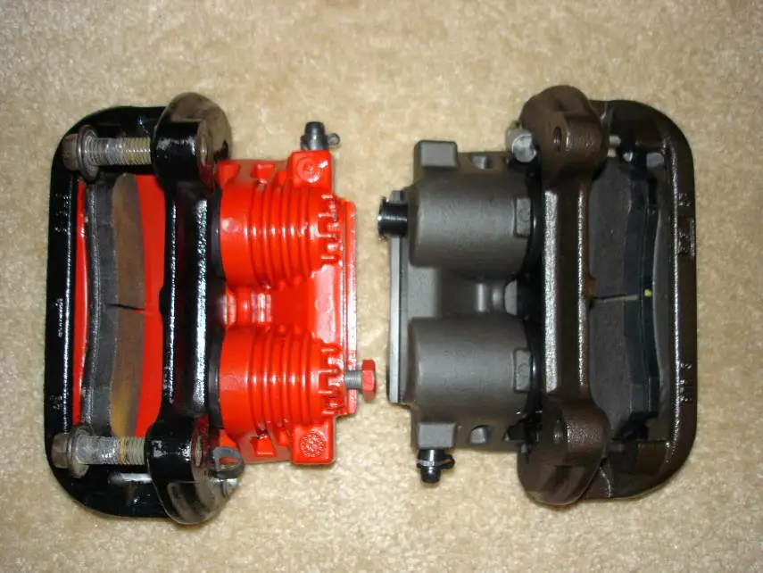

In terms of identifying your calipers....
38mm piston on the left...notice ribbing around the piston bores
40mm piston on the right. Notice no ribbing
Hopefully that helps
