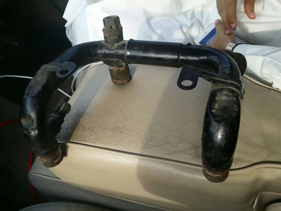

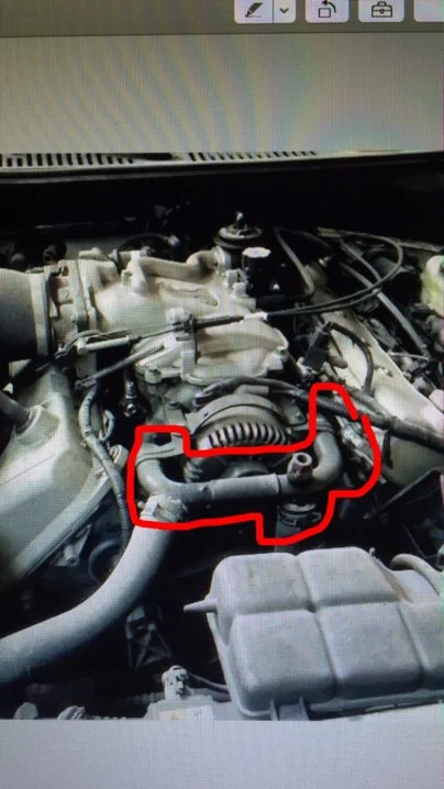

Hello everyone,, A friend of mine is having an issue with his 2000 cobra because we can't find the part he needed online, we are not in the states but we can order the part online once we find, we have been searching for this part for too long cuz we don't know what is it called and we don't have the part # I attached pictures of the part, so anyone can help us finding the part we will be very very thankful. I know you guys won't disappoint us. Thank you.
It's called a Coolant Crossover. It's for 96-98 Cobra.

Be mindful that there 01+ Cobra Mach1 also has one that is similar but does not fit your car.

I think if you find one new, it'll be like in that second link I provided. It'll probably be someone making them on the side. You might get lucky and find NOS.
I've seen a thread or two about a crossover tube delete too. Might be worth looking into if you can't find one.

Hell man... If it really came down to it, I might try sweating some copper pipe together to fab something up.
The hardest part for you (since you're overseas) would probably be coming up with an SAE threaded bung for the sensor. hehe
