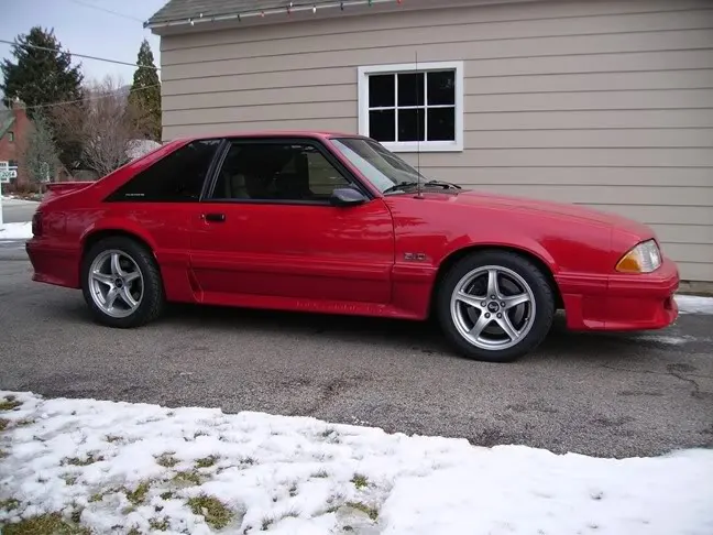

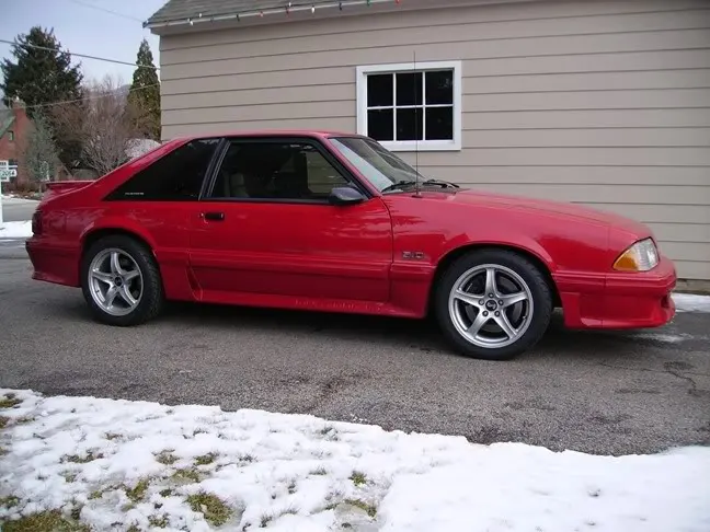

Here's the car with new 98 Cobra rims and BFG KDW 245-45-17 tires.

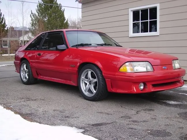

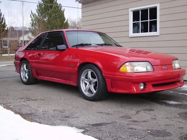

Another side shot:
Brakes work great. Feels pretty good with 93 MC and stock booster. I may eventually get a 93 Cobra booster, but this works fine for now. Tomorrow I need to fully bed the pads and rotors in, and play with the adjustable proportioning valve to see how it really works. I did a home front end alignment and ran to the tire store to get an alignment, they said it was pretty close! The total cost for the brakes alone was $1352. Thats $800-900 less than the M2300K kit for the same thing.:D
