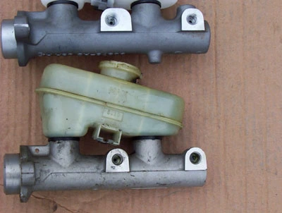

I installed my Cobra brake kit and when I went to install the Master cylinder the outlet ports on the Cobra Master cylinder were different sizes. Small in front and larger one in back.
Anyone else have this problem and what did you do to fix it?
Can you get replacement lines?

Cobra on top stock on bottom.

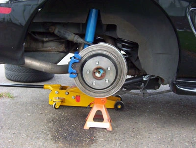

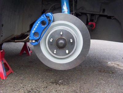

Here is a pic of the front kit and the rear kit.

I think you can just use the GT master cylinder.

I remember reading a write-up about 2 years ago on the Cobra M/C swap, and you have to get a fitting for I think the larger side, and cut the stock line, remove the stock fitting, put on the larger fitting and re-flare the line. I think this is why most people stick with the stock M/C when they do the Cobra brakes, I did and I love the pedal feel, its nice and firm and provides more than enough pressure to lock-up the front wheels (ABS).

I went to a place here called G&J aircraft and had some custom SS lines made with the correct fitting, plus they look bad a$$ and only cost me 40.00, the fittings are actually the same size as the GT M/C, but there switched backwards so take the gt m/c to a local place where they make lines and fittings and they will hook you up.

The reason I got the Cobra kit was so I could replace everything so I don't want to use the stock MC.

I just bought the cobra.... lol, I did just put SS brake lines, cross drilled and slotted rotors front and back and new hawk pads all around this weekend. The car stops on a dime now. I'll put pics up if anyone wants to see what they look like.

I'll post better pics later but here's a quickie.

Nice I want rims like yours they show off your set-up great.
