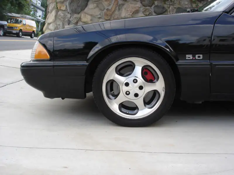

Can one of you post a pic of this? I've bought an 87 GT for a winter project and the brakes are horrible! I am pulling the 5.0 out and putting a 418 stroker in it, so I want to possibly change the braking system over as well.
Of cobra brakes on a fox? Best mod I ever did. The car is much more fun to drive when you have confidence in your brakes
