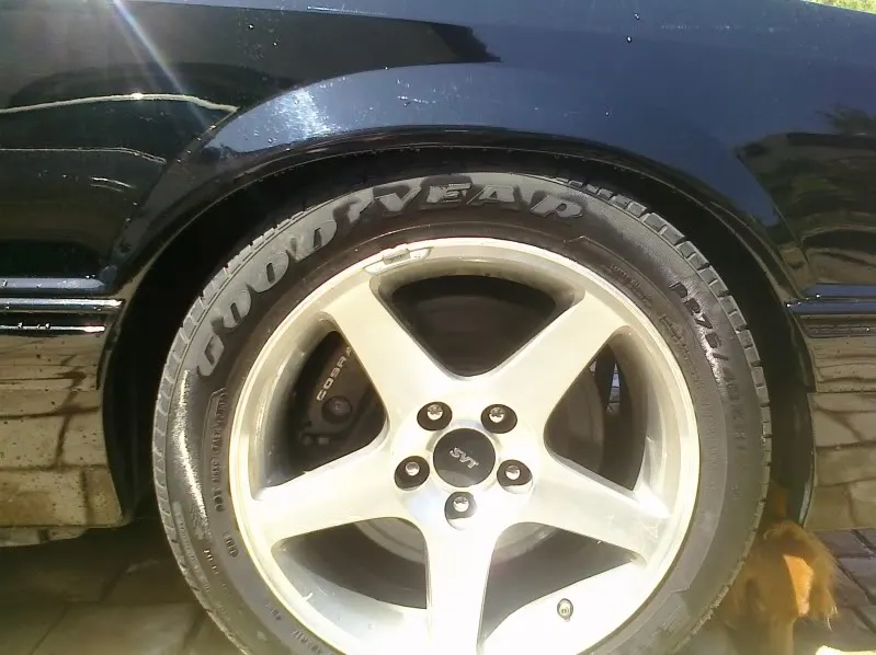

Ok, I have everything finished and brakes seem to work great. The issue I am having now is that the front tires are actually resting on the fenders. I have the Eibach Pro-Kit and I am sure that is the culprit. I need to make some suspension adjustments. Any suggestions? I was thinking Maximum Coil Overs and being able to adjust the front ride height. Opinions and experiences?

It is hard to tell but the inside of the tire is touching the inside of the fender well.

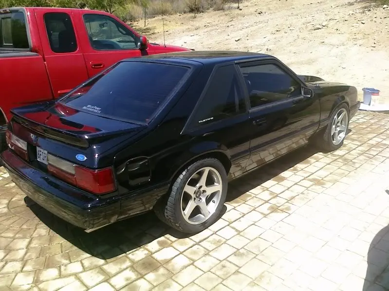

notice the height of the car
My tires are inside of the fenders already. The ride height is to low it can be raised at least 2" and still be "slammed". I am thinking a combination of Coil Overs and a narrower tire should be able to fix my issue. Plus I can level out the car front to back. Your front fenders have a lot more gap than mine does, I wonder why that is? My tires tuck under the fenders.

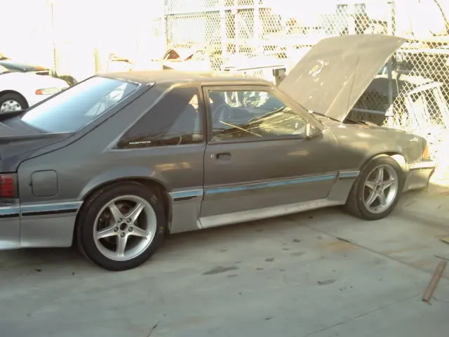

Pics are on my home computer, but I once had Eibach Pro's and they were not near that low up front. I had 98 Cobra's (17 X 8) with 255/40's. On mine, I only installed the top isolator. The bottom crumbled when removing it from the factory spring. If needed, I can post a pic tonight.
