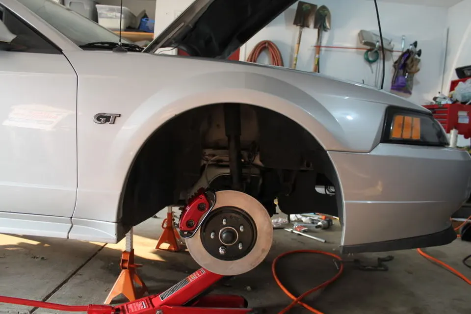

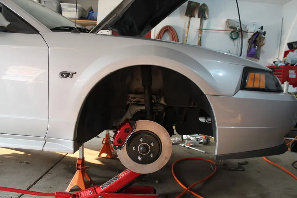

I have those powerslot rotors and they have been good so far.
