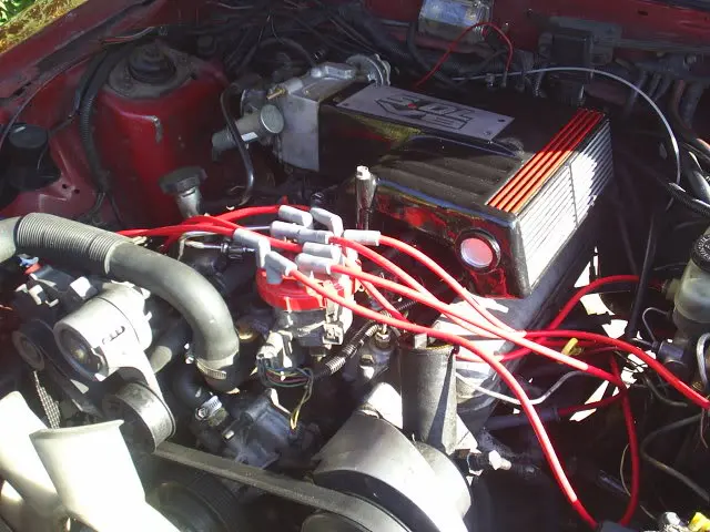

i have an 96 explorer upper, got a nice high end SOTP kick but low end "hop" went down a little....
i paid $100 for the upper (thanks Rio5.0) which had the runners nice and smooth..
