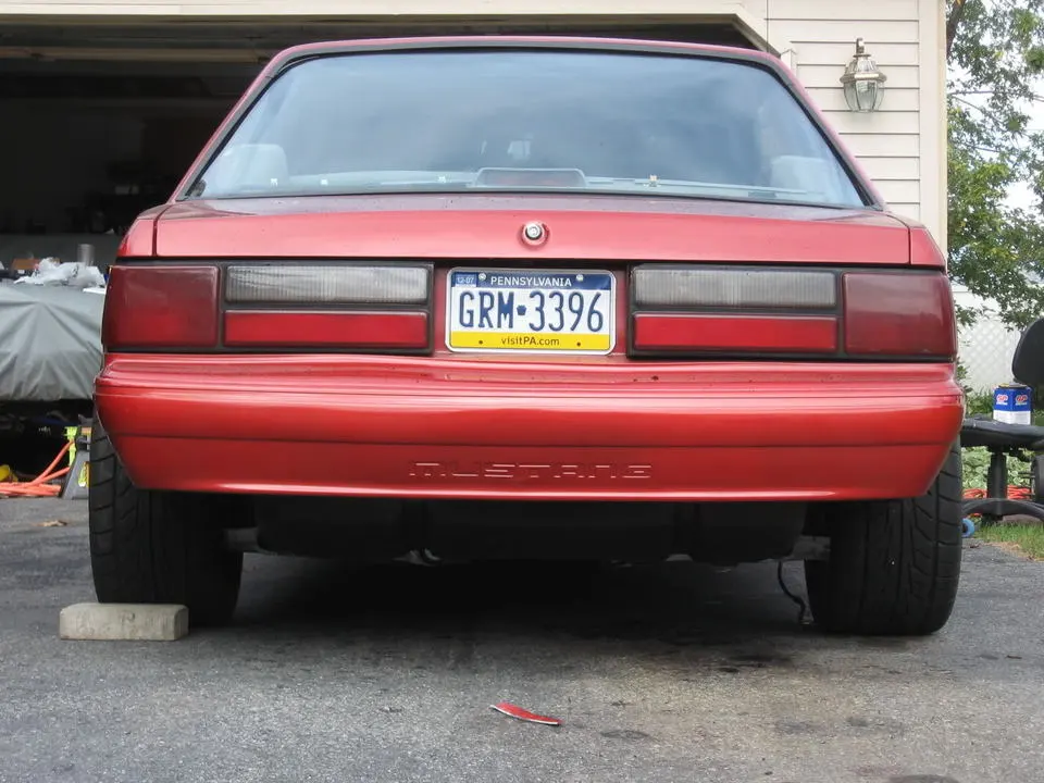

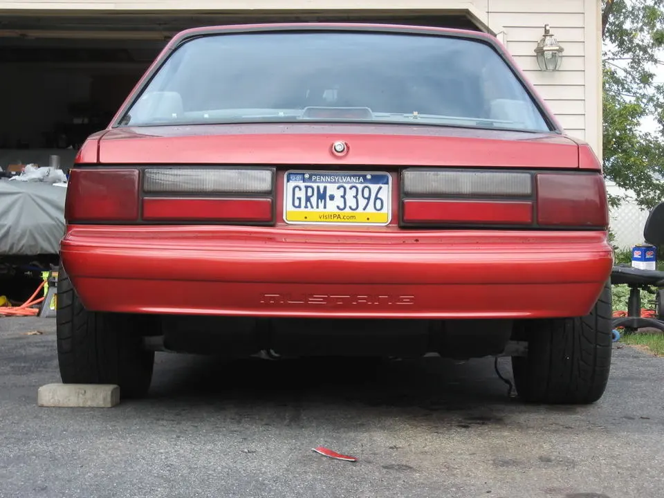

I just finished putting a IRS unit in my fox, got it off Ebay for 550... waiting for springs to come in. I had to cut to stock ones so i could get the car on the ground and move it around, so as of now the tires are resting on the fender wells. The write up from mouth breather is good i sued that to show my buddy what we needed to do before we started. You can't see it in the picture but it did kick the tires out about an half an inch or so. hopefully I'll have it driving by this weekend and i can chime in on what the difference is.

68FBJJZ109 what wheel are you using, wheel to wheel looks really wide. I know there is a difference in track width with the irs inch and half or something like that, for that reason there is a certain backspacing to use.
There 17x9 with 24mm of backspacing. They come right to the outside edge of the fender lip. Also the IRS is all buttoned up, Night and Day difference. I took a friend of mine who has a Lincoln MK 8, and he was very impressed with the ride quality and how it handled.

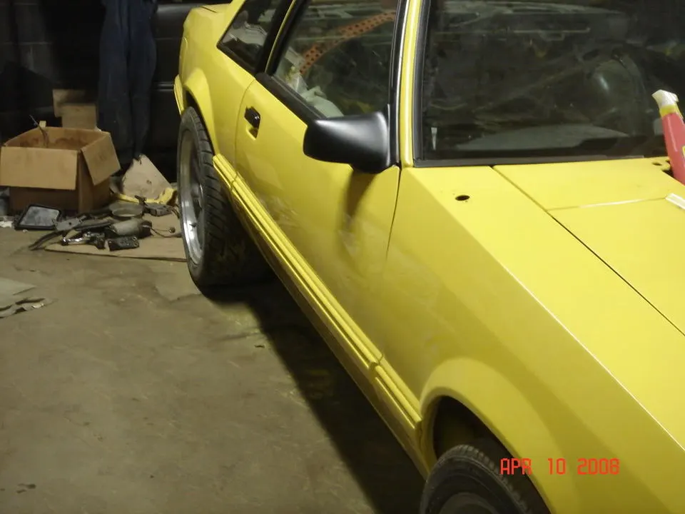

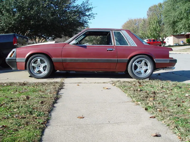

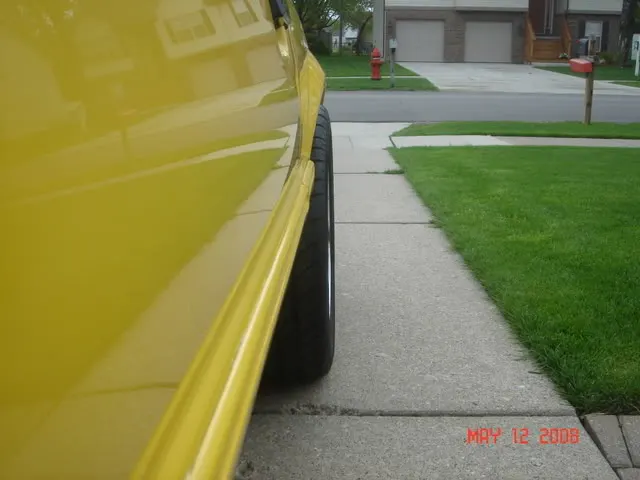

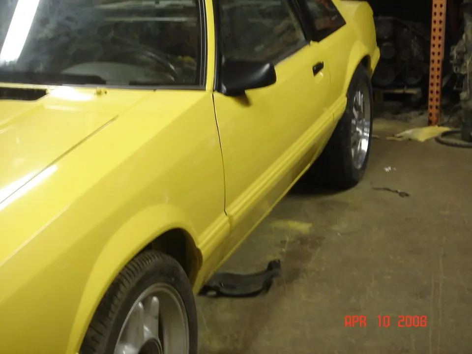

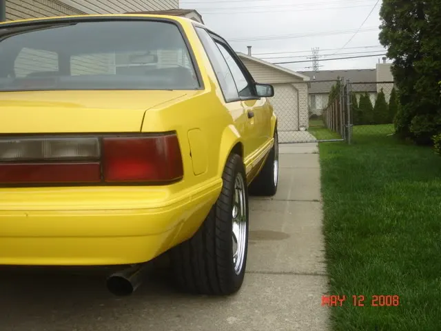

Your welcome!!:D The 99-04 Bullit wheels that are 17X8, will fit just fine. They will be just inside the quarter, and I mean JUST inside. I have the 2001 GT solid axle in my notch and that is how they sat. The 17X8 05+ wheels are inside 15mm more. And the 17X9 05+ wheels are sitting right out at the edge like the 99-04 17X8's were, but, because of the extra 15mm offset, that extra 1 inch of width is all under the car, making it look really good. Let me share some pics with you.
17X9 05+ 45mm offset
Same
Compare these.
Driver side is 17X8 +45mm offset
Passenger side is 17X8 +30mm offset. Sits in and more backspacing under car. Also, pay attention to where the wheel sits, not the tire because the 05+ wheels have the silly 235-55's.
Hard to tell on the last two pics, but the difference is huge.
BTW...I rolled my quarters before I did body and paint work. I think it was necessary. I also welded bump stops on the frame rails. I have hit those about 3 times over the past 300-400 miles. Not bad really. Mostly over railroad tracks, or bumps under hard acceleration. If I didn't have those, I prolly would have touched the tire to the quarter panel on the very inside.. :eek:
