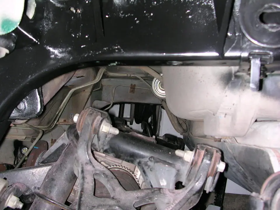

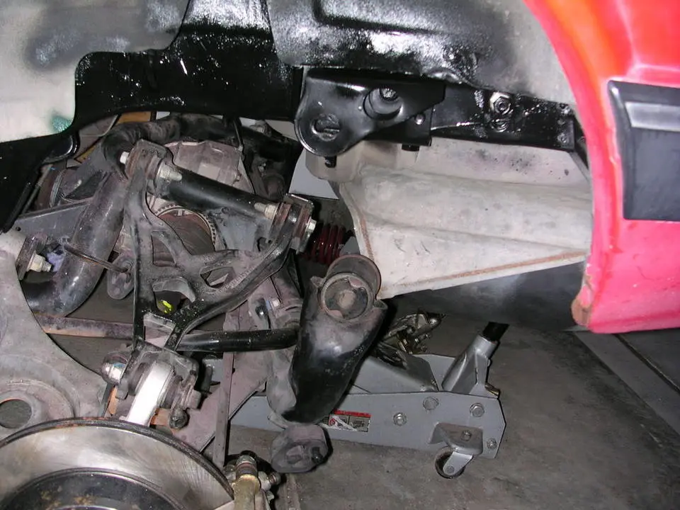

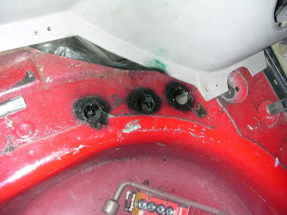

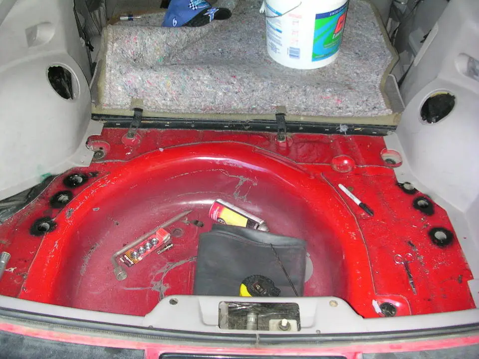

Just wanted to share some pics of my progress.
I used a 1 3/8th holesaw to get into the framerail.

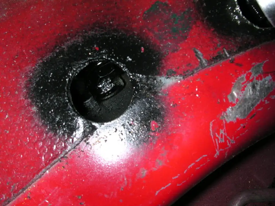

Here is a sucky closeup of how I just cut a corner off a bolt head and used the current nut that is welded in the framerail as a support to keep it spinning. I figure that way, the bolt is flush and not crooked or going through both sides of the framerail. You will see a couple pictures down that the nut is on the outside of the rearmost bracket.
Next is the trunk with all the holes.
Next is with the front bolted in.

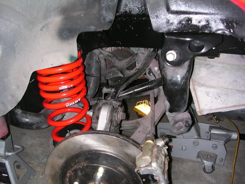

With the H&R IRS race spring.

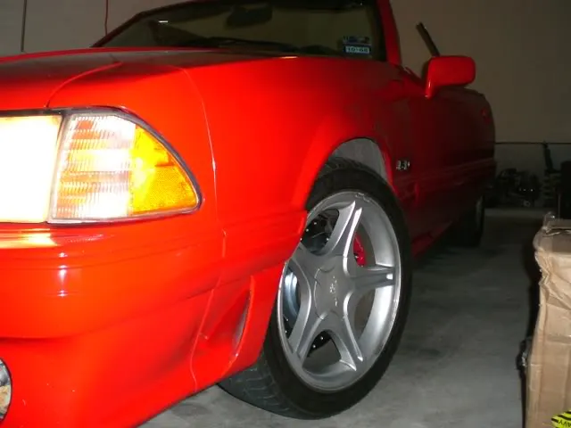

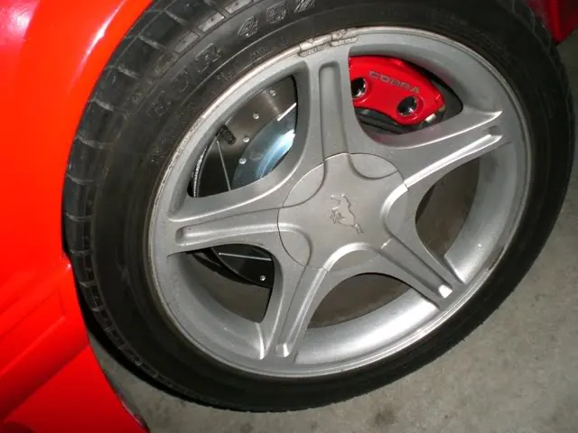

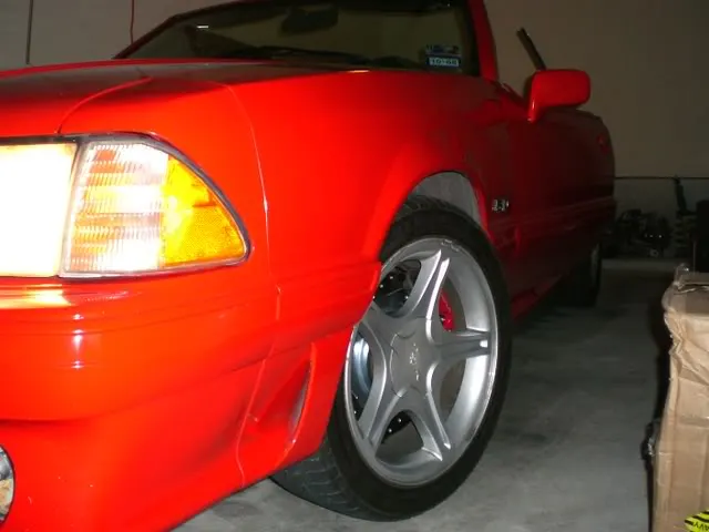

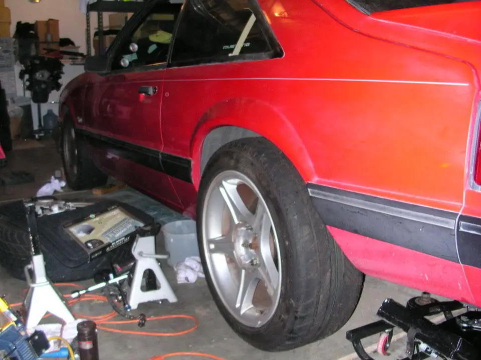

All 4 wheels on the ground... Have yet to move it around to see if the springs squat a tad more.

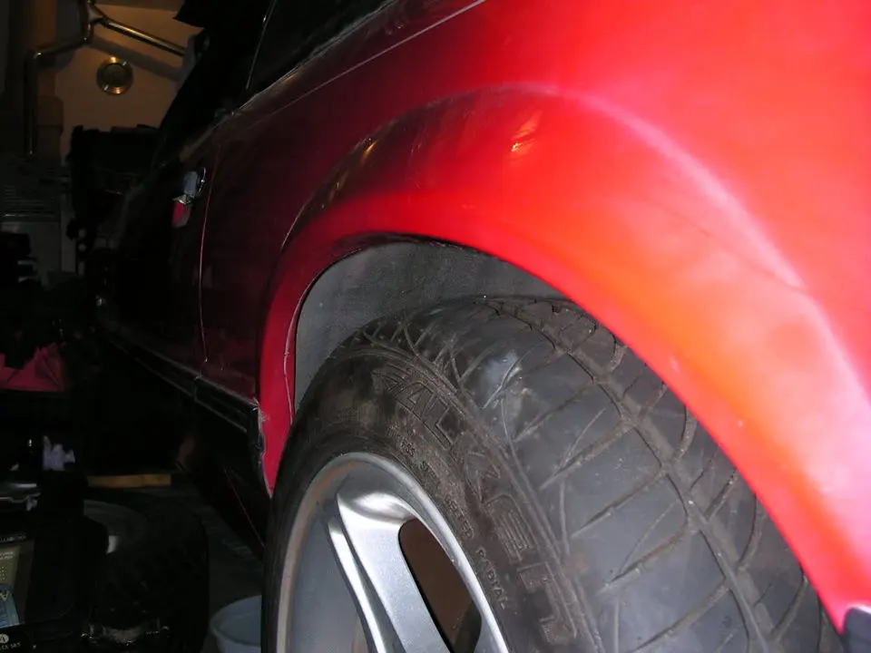

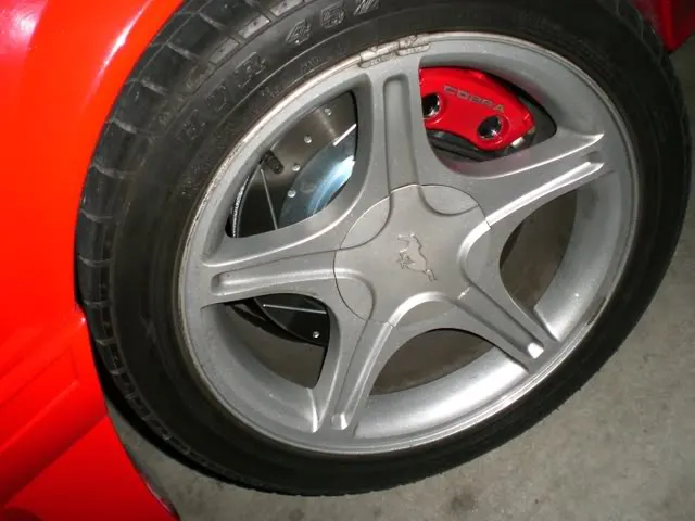

And the cleance with 245/45/17
he brake conversion isn't done yet so I cannot tell you how it rides yet... Need a little more time and money but I have most of the parts for that at least.
Kevin

When you choose your wheels, be very cautious of the width. Anything wider than an 8inch with the sn95 backspacing is definately going to rub... 8inches might still rub. It's going to be close if I am guessing right. I have to wear out the current tires to justify even looking at wheels but the sn97 wheels as mentioned before fit a lot better with their offset. Just something to be mindful of.
Kevin
what about wheel spacers?? would you be able to fit like a 9 with wheel spacers? :shrug:
Unfortunately wheel spacers go the wrong way. The IRS is about 3 inches wider than the fox axle... Sorry I wasn't clear before. The clearance issue is with the body of the car not the wheel well.
