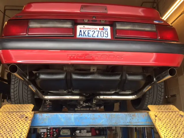

So I've been driving the car, mind you open h pipe, and it's incredible the difference in the car. Now I'm trying to figure out a solution for the tail pipes on the IRS exhaust to the fox. does anyone have pictures of how they mounted the tail pipes?

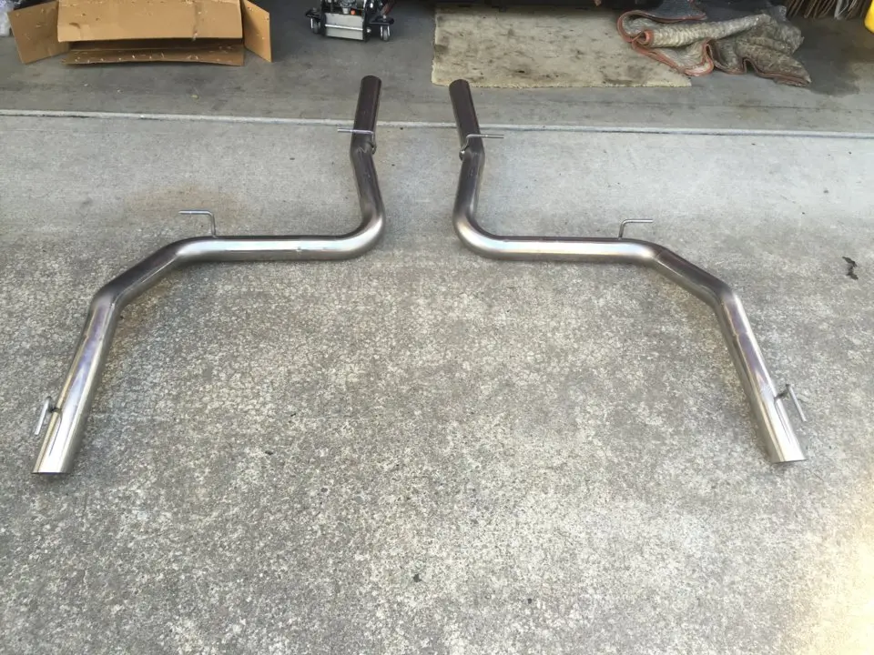

I ordered SS tails from VRS exhaust.
I have a Flowmaster IRS catback on mine, but I had to cut and weld the passenger side flow tube to shorten it in between the H-pipe and the muffler as it was too far back and hitting the pumpkin. You can just order tailpipes if that's all you need, but you should know the IRS requires inboard-inlet:inboard-outlet mufflers and normal for a 79-04 SRA car is inboard-inlet:outboard-outlet mufflers so just adding tailpipes won't work.
