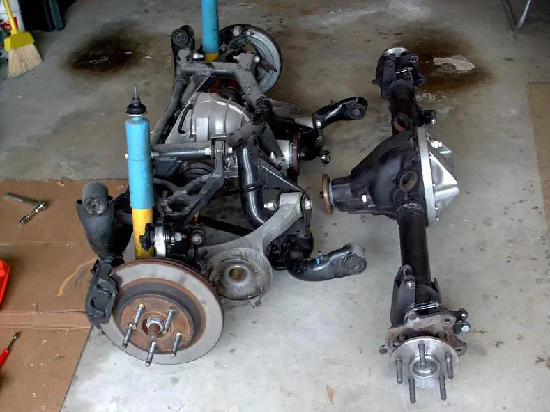

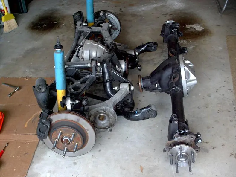

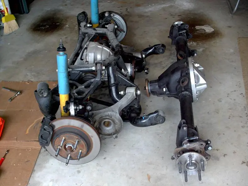

Look at this monstrosity for Christs sake!

Rotor weight, brake caliper/pads, and struts are added to the IRS weight (not judging by the pic, but I bet that's why)
Ever carry 2 boxes of rotors before? :p

That picture does not represent what was weighed, it was merely added for visual impact to illustrate how many more components the IRS consists of. If I ever personally remove mine I'll make sure I remove the calipers, pads, struts, etc. before snapping a pic. :p
As for why the 03/04 gys report almost 150lb weight savings I can't say. It's just what most all of them report. :shrug:

That picture does not represent what was weighed, it was merely added for visual impact to illustrate how many more components the IRS consists of. If I ever personally remove mine I'll make sure I remove the calipers, pads, struts, etc. before snapping a pic.U.M.
That is why I said
