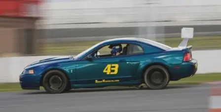

And yes I am still running my IRS and have no issues with it at all. Even with 335-30-18 hoosier slicks in the rear. As far as wheel hop. I dont seem to have those issues either on those rare times when I like to kill a perfectly good set of tires LOL
Most road racers that go with a solid rear have a very modified type like a torque arm or 3 link and or some kind of watts link.

Dude, you have the cobra for the IRS, add some sticky fat tires to the rear for drag. I have had 2 solid axle cars and the IRS I have now owns both. I can corner way better than I ever could without dumping $5K + into the SRA cars. And I personally have little issue with wheel hop. I dont have a vert. but I do have a 99' snake. And most professional road race mustangs that handle well are Fox cars, for the power/weight ratio. I would hate to see you lose the IRS and seriously regret it. I have had an 02 GT and a 92 351W Fox, and this IRS system rocks them both. I will say I am partial to handling mustangs, not a huge drag racer here.

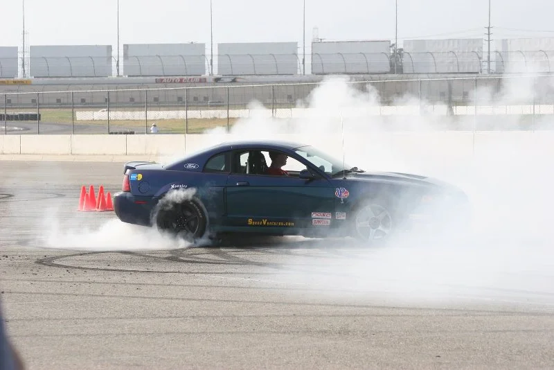

i finally got to experience the IRS Hop. pretty wild but it was a pretty odd occurance. got a little over zealous in the rain, got the rear lose with little throttle, then decided to keep it loose and added alot more throttle and all hell broke loose. i almost instantly let off, i do have a IRS Brace but still.
tried to recreate the experience on the next turn but nothing, just spun the rears to no end even under wot.
a lot of times the car will hop and you can drive out of it byu matting it as soon as you feel it start to hop. This breaks the tire completely loose. I've only had one really bad case of wheel hop that scared me. It can be really vilolent but i'm on a completely stock 03 rear end. The 03 cars have enough torque to drive out of the wheel hop. I don't think the 99's will. That may be why it is worse with them.
Personally I would NEVER attempt to drive out of wheel hop by increasing throttle. That's the main ingredient of the recipe for a broken half-shaft. Seen it a many times...

100% agree. It's just stupid when people do so; it's not like it's making them any faster to drive through it. Best way to stop wheel hop...learn to drive better :nice: After that, full bushing setup haha :nice:
