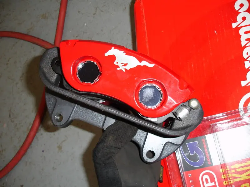

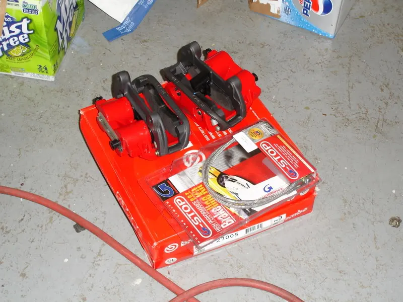

the pads mount to the caliper but are also held in place by the caliper bracket. those tabs arent the sole thing that is stopping the car.
I see what he is saying now. The retaining pin that holds the caliper to the bracket just physically retains the brake pad, which attaches to the caliper by those two mounting hole tabs. If the two holding tabs on the pad gave out, the retaining pin wouldn't secure the caliper, thus making it loose.

Exactly. Thanks for posting the pic.
