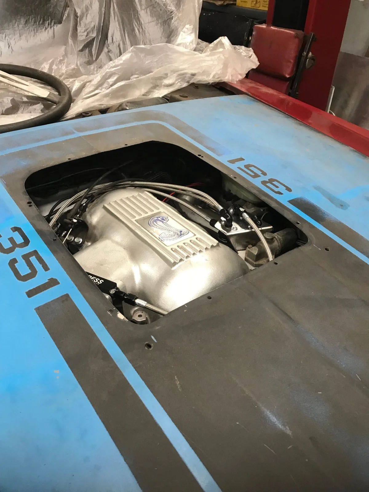

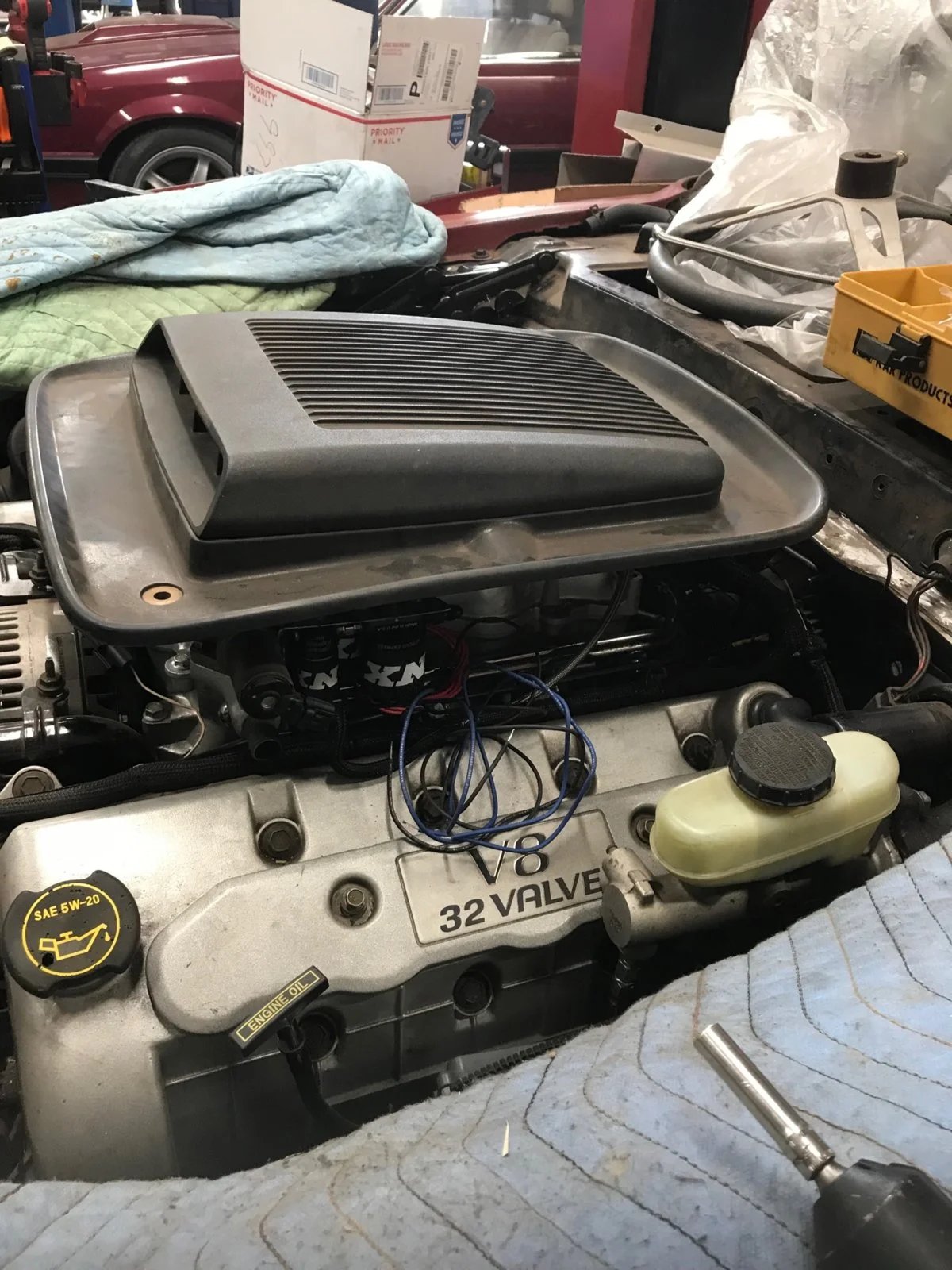

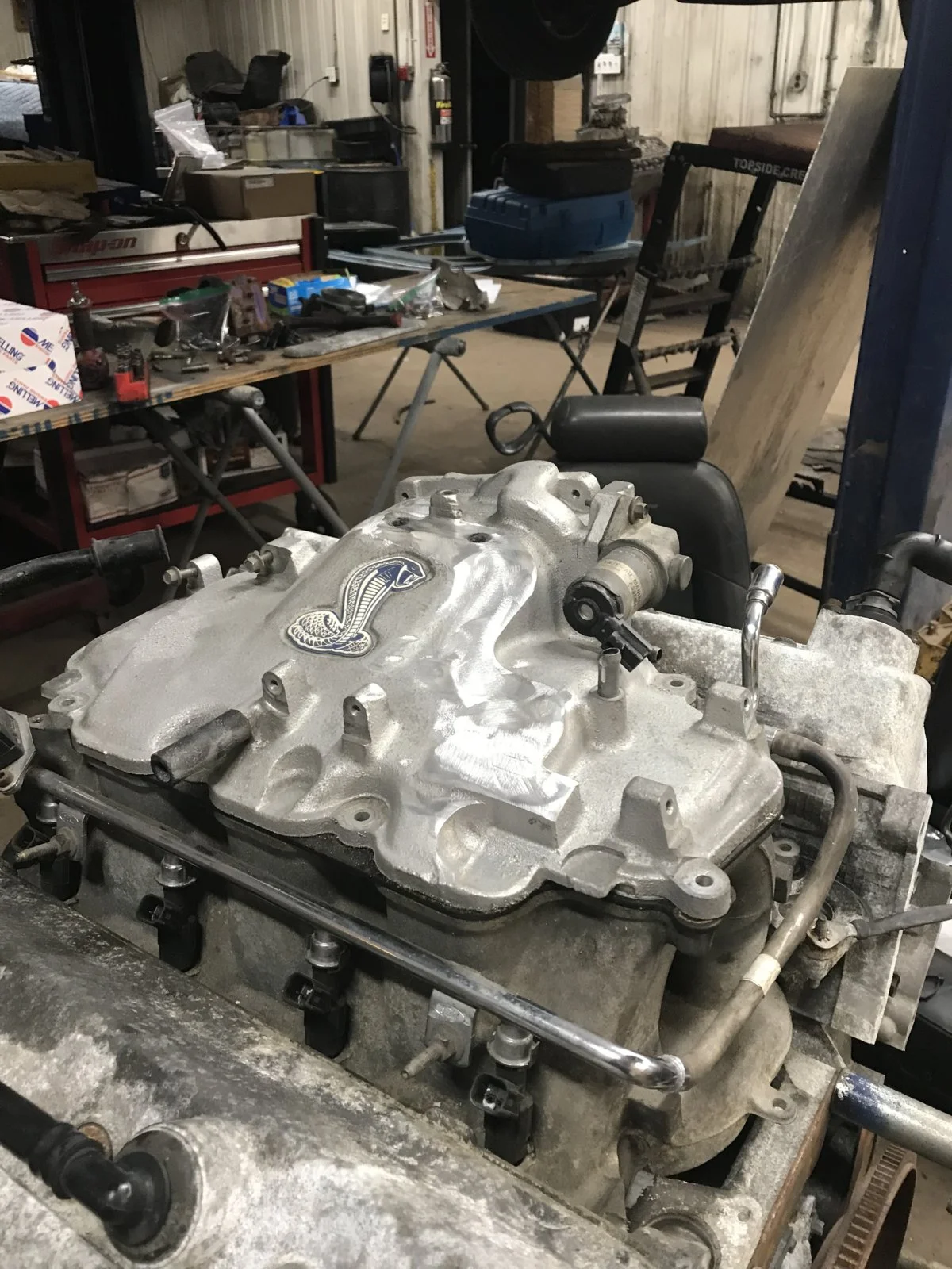

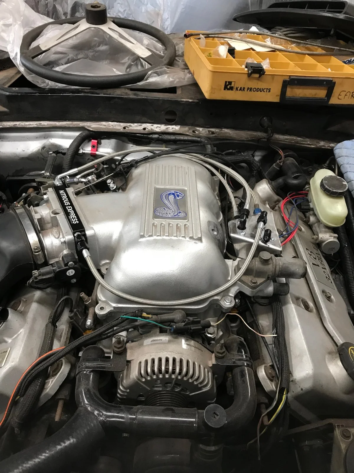

Im putting a 04 4 cam in my 69 Mach, started with a 98 Cobra engine, using a 4r70w tranny. Ive engineered everything myself. You can message me or call me if youd like. I have 36 years of wrenching years under my belt. Own my own shop.
Wow, that sounds awesome. Hoping to get 97 motor pulled this month and get it rebuilt. How did you handle the wiring? I have a buddy doing a similar build but he sent the ecm to Ron Francis and they built him a wiring harness and deleted all the stuff from the ecm he wasnt planning to use. Are you running ac and heat? How did you handle that to?

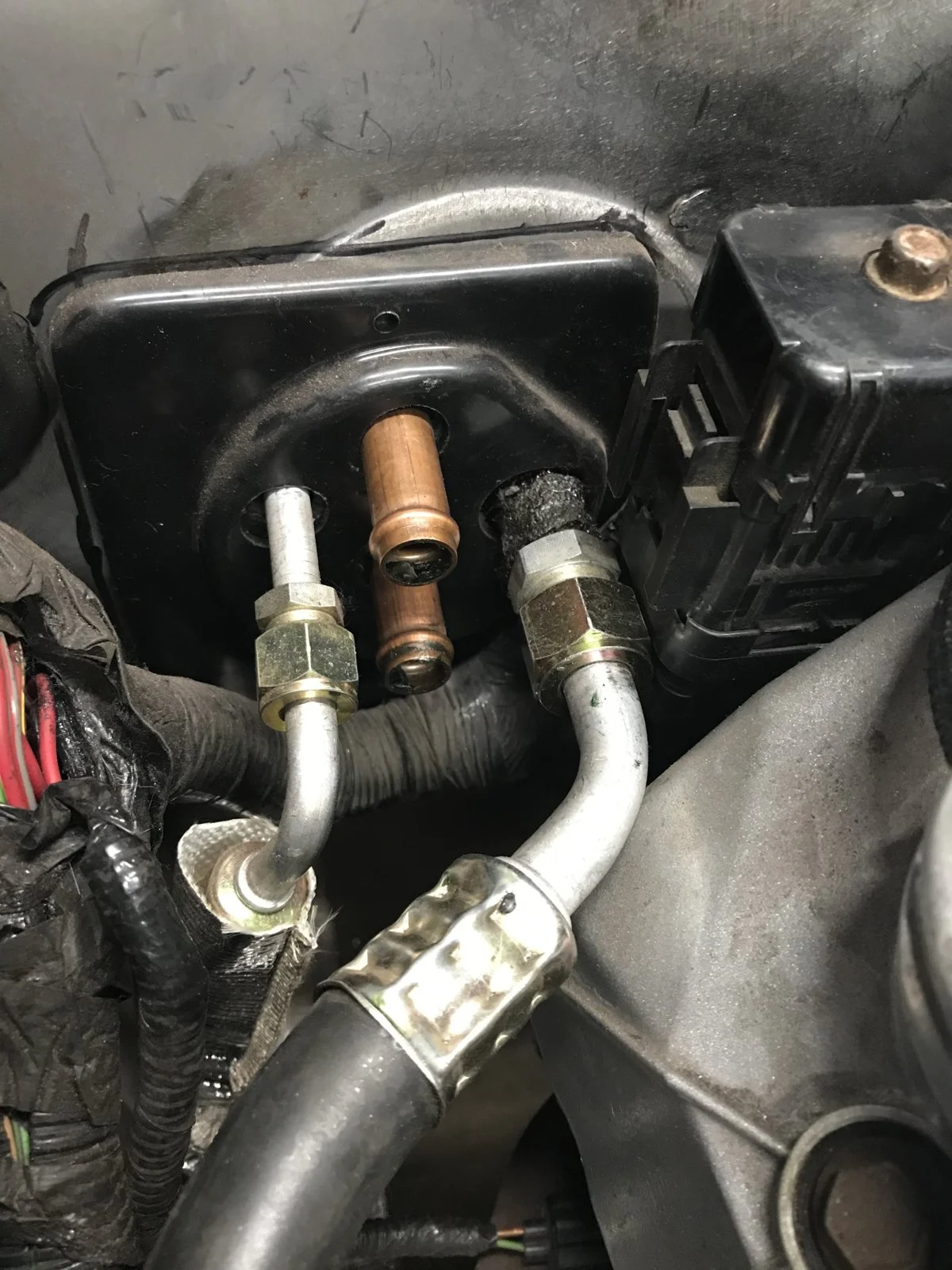

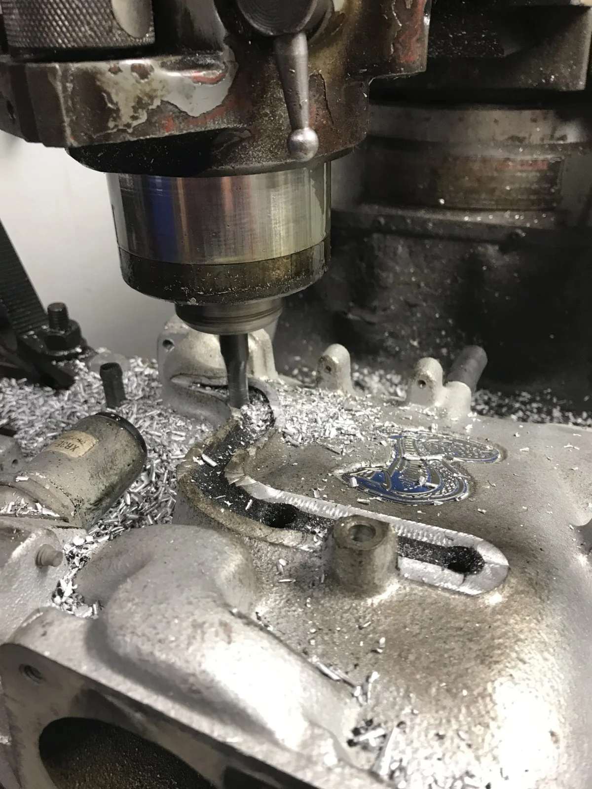

Im using a 2000 GT computer and harness, modified both harness and plenum myself. Yes both A/C and heat, cruise control also.
That looks so awesome! I'm overwhelmed but determined to figure out how to get this done. Hope to be pulling motor/trans from cobra next couple weeks for rebuild. I also want to keep the AC and heat. You modified your donor car heater/ac box to fit the 69? What brake booster did you end up running?

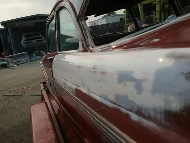

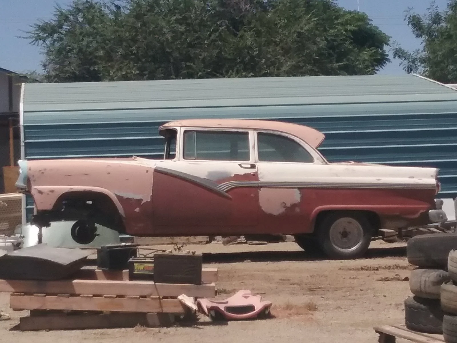

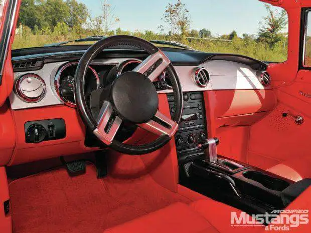

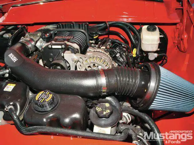

I have kind of the same plan with a 56 Ford ,i will be using everything from a 2005 GT ,heater AC box ,brake booster and interior into the 56 . It all fits pretty easy into a 56 ,would take some work to put into an early Mustang though .these are some pics i found on line. I know it isnt a Mustang but it makes use of a wrecked 2005 GT with low milage
Reactions: Jckmustang
The old Ford looks rough but it is actually the straightest one i have ever seen with only a couple of dings and brown primer over the original buck skin and white paint. I am not sure what the Cobra has for motor mounts but the 05 GT has aluminum mounts that look like it will be very simple to use in the 56
