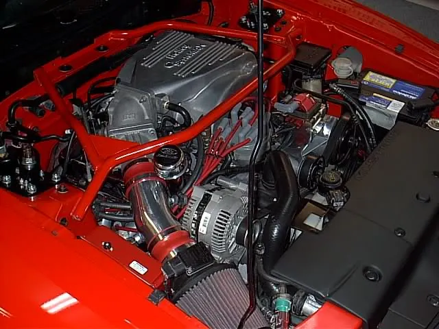

I used a 70MM Throttle Body and Pro-M 77 MAF on my Holley intake. I also took a wire wheel, installed it on a drill and cleaned up the Throttle body opening on the intake. Also if you're running the elbow you'll need to open that up as well. It's not 70MM. Which AFR's? 165's?
