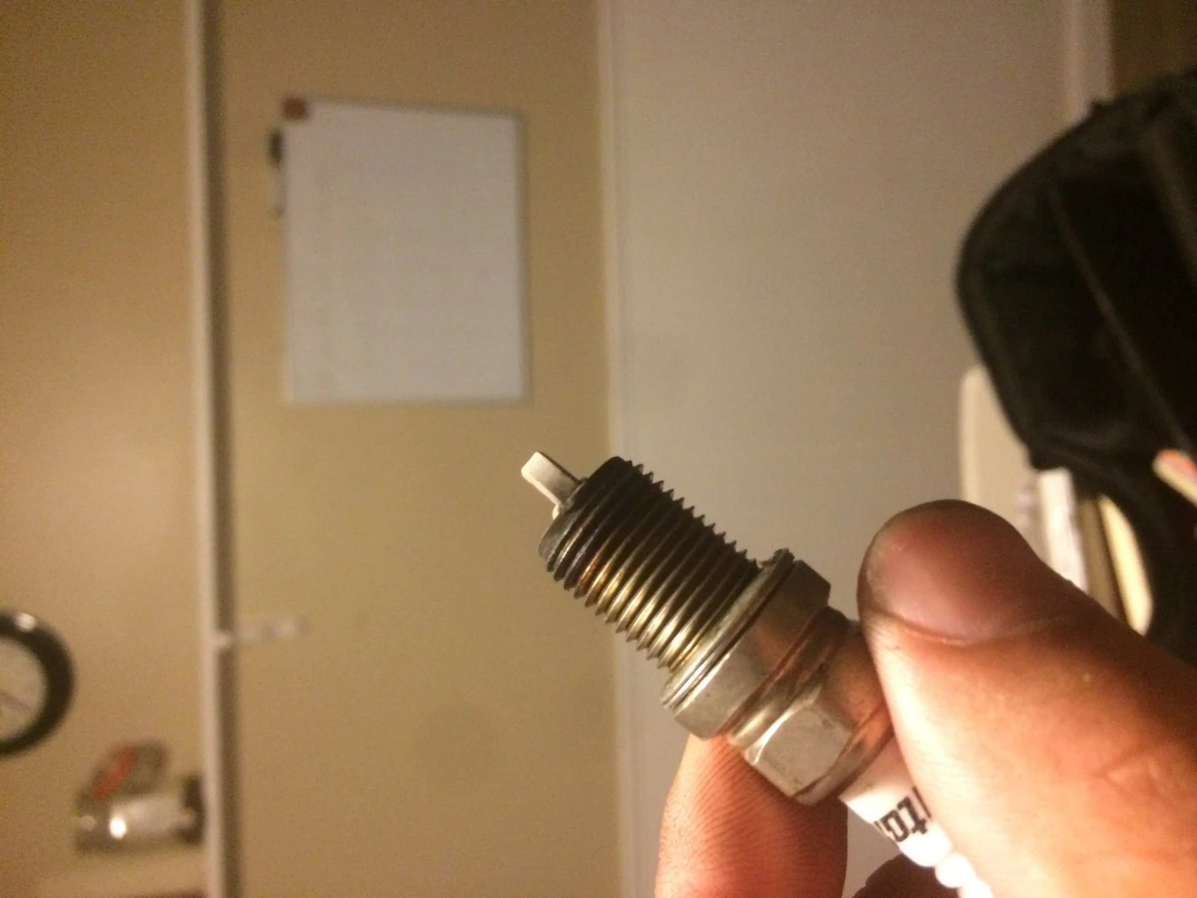

Ok, new screen is in and a little RTV has the PCV valve in tight.
Well, when it rains it pours
When I started back up I noticed a coolant smell around the passenger side head. It was pretty strong and after a drive I checked fluid levels and am definitely losing coolant. However, my oil is not milky and I have no white or blue smoke from exhaust. Here is a picture of a plug I pulled from the head. Let me know what you guys think.

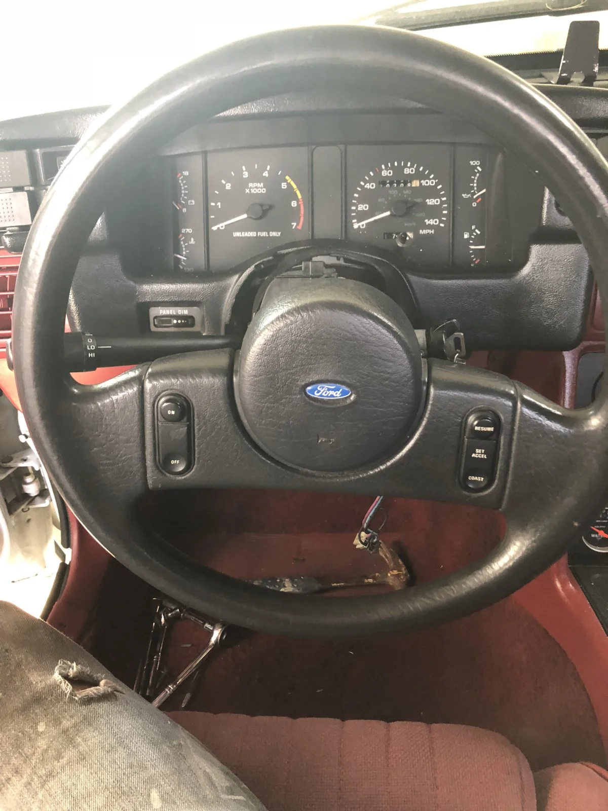

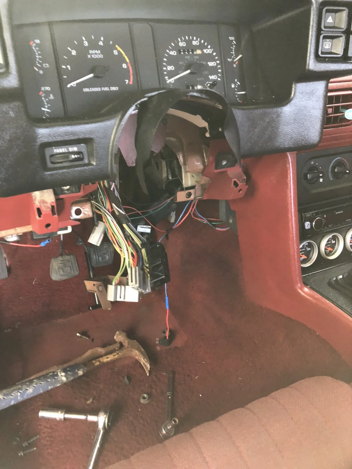

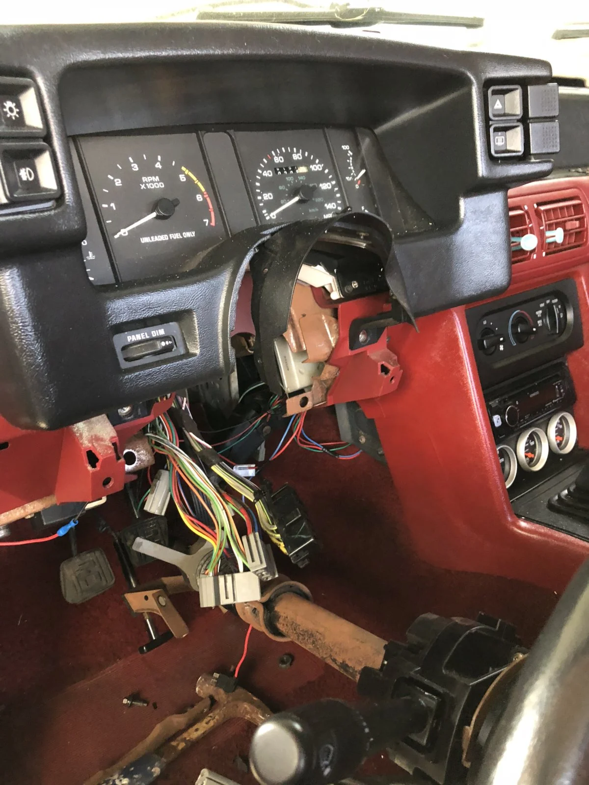

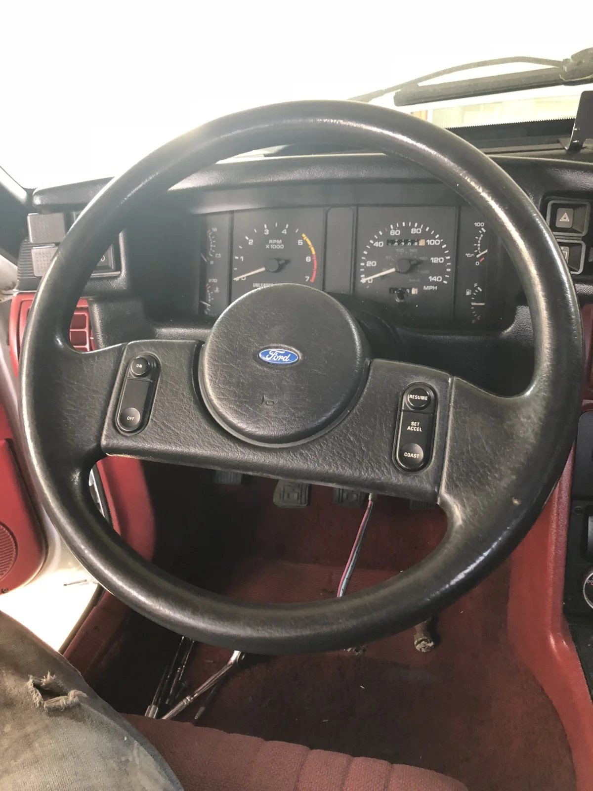

Yesterday I started on my mods for this season, but unfortunately Mother Nature was not having it today. Tilt steering wheel and new MM shaft will be going in first.

What column are you putting in? An 87-89 tilt?

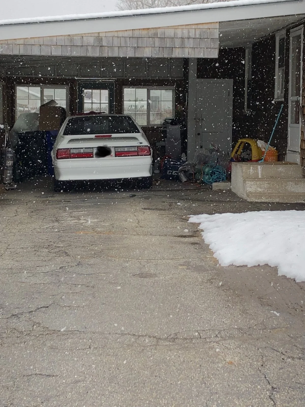

Same here. I was also set to start my spring landscaping plans...and it snowed today.
Yes sir. Found a nice one with key. The plastic part on the ignition switch popped out in transit, so I’m just gonna swap out the one off the old column.
Same here. I raked the back yard on Sunday and was all ready to hit the orange store to grab some weed and feed. Foiled again.

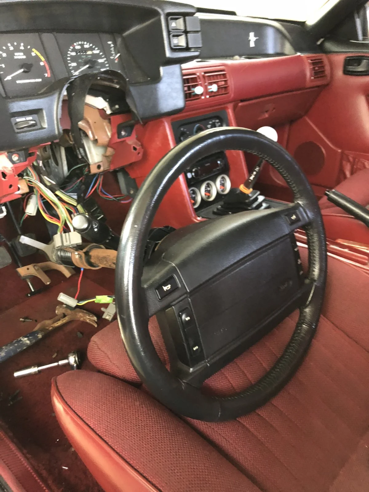

Tilty tilt. I actually haven’t installed the new shaft yet. I know, I know I should have done it with the column out, but I wanted to get this in so I could get the car running. I need to tackle the low MAF voltage code and get this bad boy on the road in preparation for the nice weather they keep teasing us with.

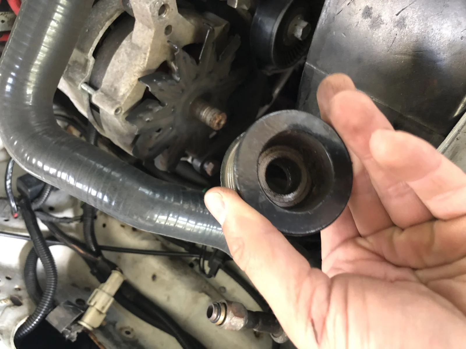

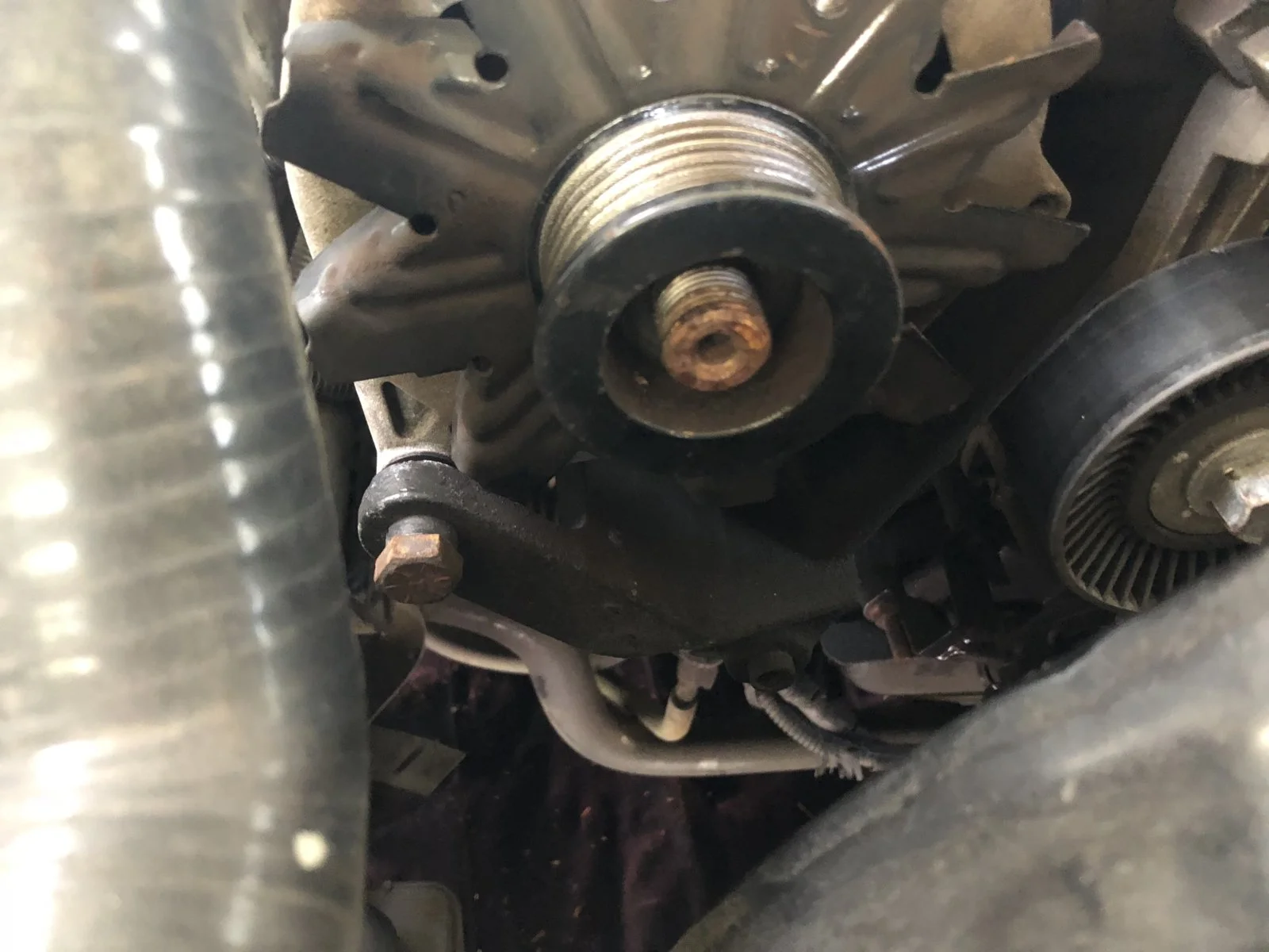

Car started making a strange grinding noise from the accessory area. Took the belt off and it went way. So I started playing is it the water pump, fan, or alternator. Didn’t take too long to see it was the alternator. The nut spun right off, I’m so damn lucky the pully didn’t spin off while driving. I have no idea how this happened. I want to upgrade to a 3g but it’s just not it the cards right now, so I picked up a reman unit for $80 bucks and am back in business.
