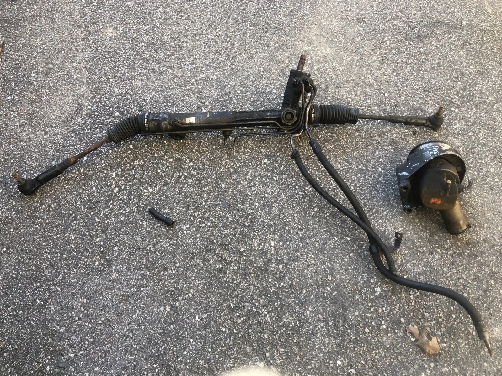

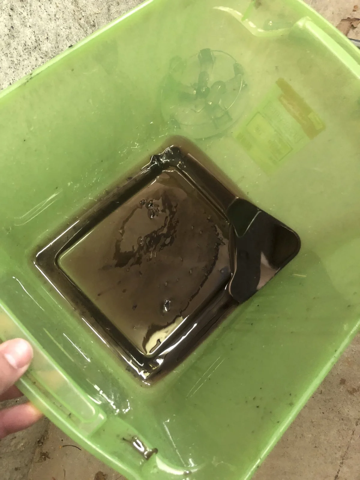

So I got all the old junk out. The amount of play in the inner tie rods was dangerous and the rack bushings were completely shot. There wasn’t much fluid in the system either, and it was sludge. I was glad to get all this out. Before the new stuff goes in I’m going to get out a brush and get all tHe crud off the k member.

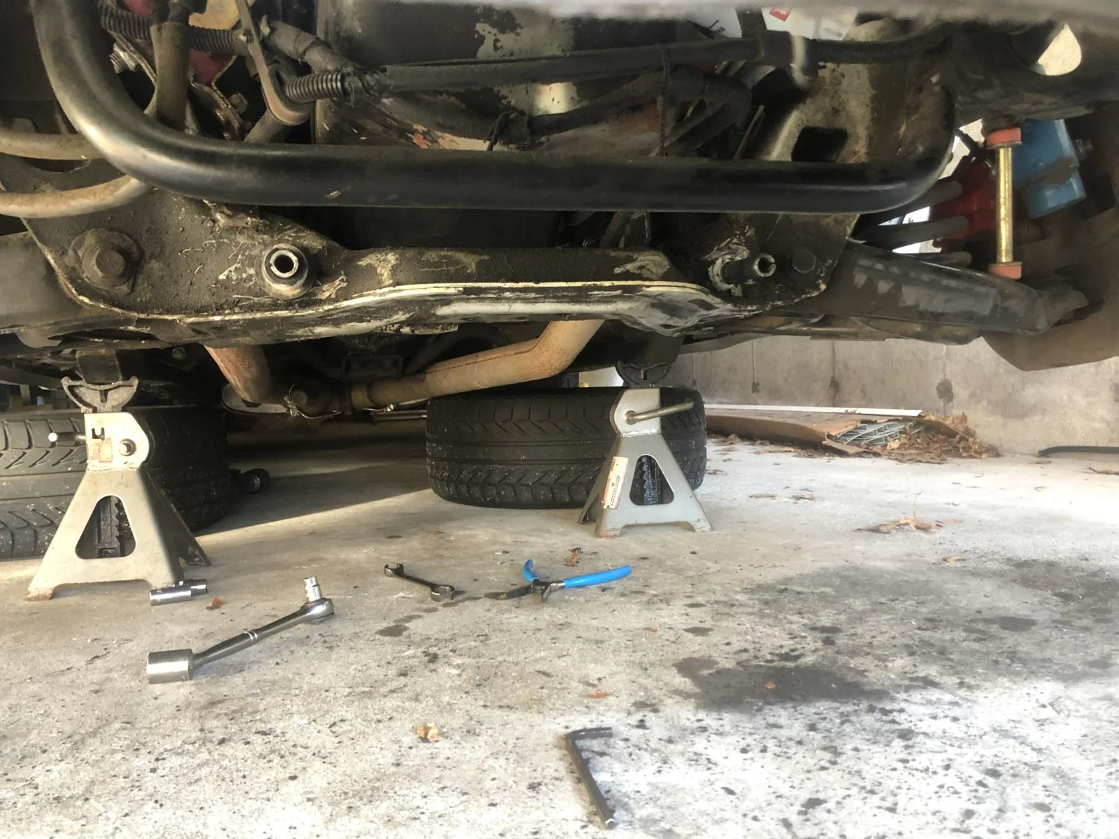

So I buttoned up the install on the rack and pinion today. The good news; real Motorcraft SP-ZM rack, new poly bushings, MM Hybrid shaft, new Motocraft remanned pump that doesn’t make a peep.
The bad news; I still have that damn slop in the steering wheel. I torqued the out of pinch bolt between the shaft and the column. The slop seems to be in the column or the steering wheel itself, and exists without engaging the steering rack.
Any ideas?
