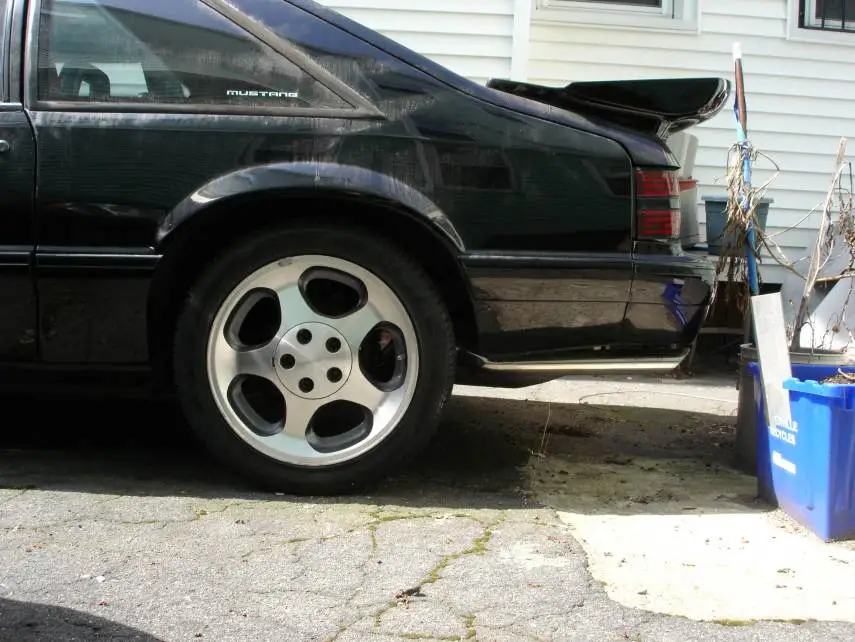

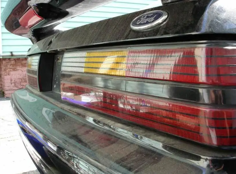

Mine are sunken in too, but it doesn't bother me. Excuse the dirty car.
