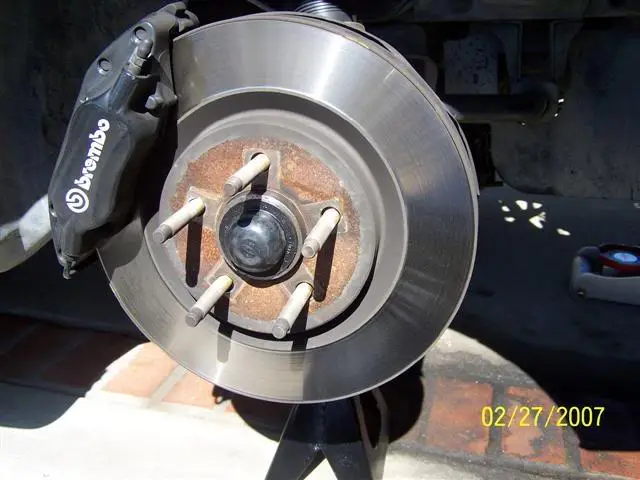

Ya, the 2000 Cobra R uses a 4 piston Brembo caliper. Here is my setup when i had my mustang.
