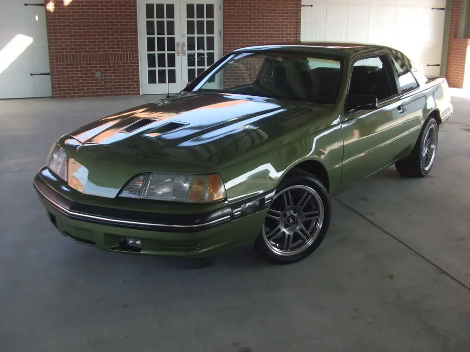

I have the 17x9 and 17x10 10th anniversary Cobra R wheels on my car.Funny how the Stang wheels fit my Thunderbird better than the Stangs.They go to the wheel lip,but not past.Just right.I did have to remove the factory quad shocks,but I was told I could reverse them to fit.I haven't tried that.
