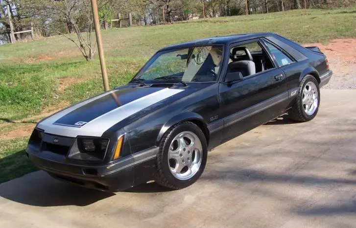

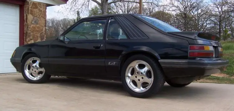

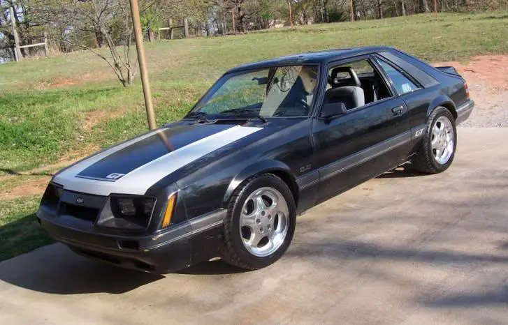

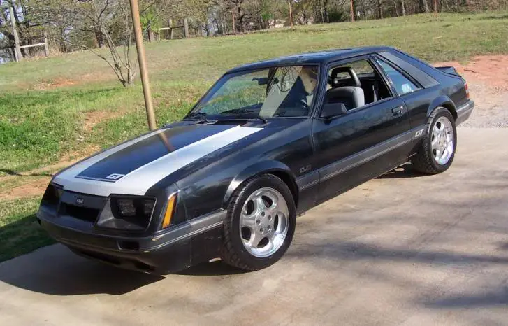

I had 94/95 Cobra wheels on my '86. They we slightly wider than 8" (don't remember if it was 8.5 or a little less). The factory tire size for those was 255/45. I think I had 255/55s on them, though. It was a while back, so I don't remember. I do remember that they rubbed the splash shield up front a little bit, but that was it. I can post a pic if you want.
Yeah post a pic please i dont know which ones they are they are the skinnier spokes of the two cobra wheels they made between 2000 and 95 i looked em up some people say they are one year and others say they are another
Post up a pic and someone here should be able to tell you definitively.

245/45-17 is the stock size for that and would probably be just fine for your car. I've seen people put tires as wide as 275/40 on an 8" wheel. Not sure if that's recommended or not.
When I sold that car, the guy who bought it threw some 275/40 DRs on the rears.
I'd buy that car back if I could find it again. :( Last I saw it was for sale about five years ago from a guy in SW Missouri.
Edit: I just remembered that what I just posted is irrelevant since those tires are slightly wider than what you have.
Im not going 245 haha
255/45/17 then.
They are 8" wide rims, you could put 275/40/17's on the rear, but your handling will suffer as the sidewall rolls over on itself in a hard turn.
You generally want to stay within 2" wider than the rim size. a 275 is 11", so you are 3" wider. A 255 tire is 10" wide.
The only Cobra to come with a rim wider than 8" was the 1995 Cobra R, 2000 R and the 2003-2004 cobra with 9" rims and 275's

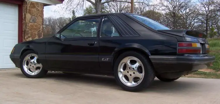

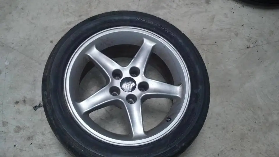

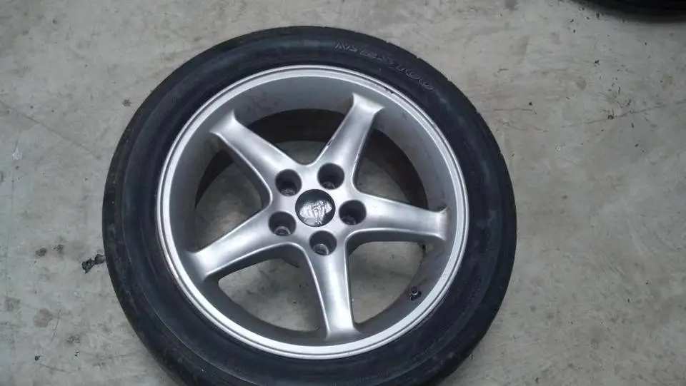

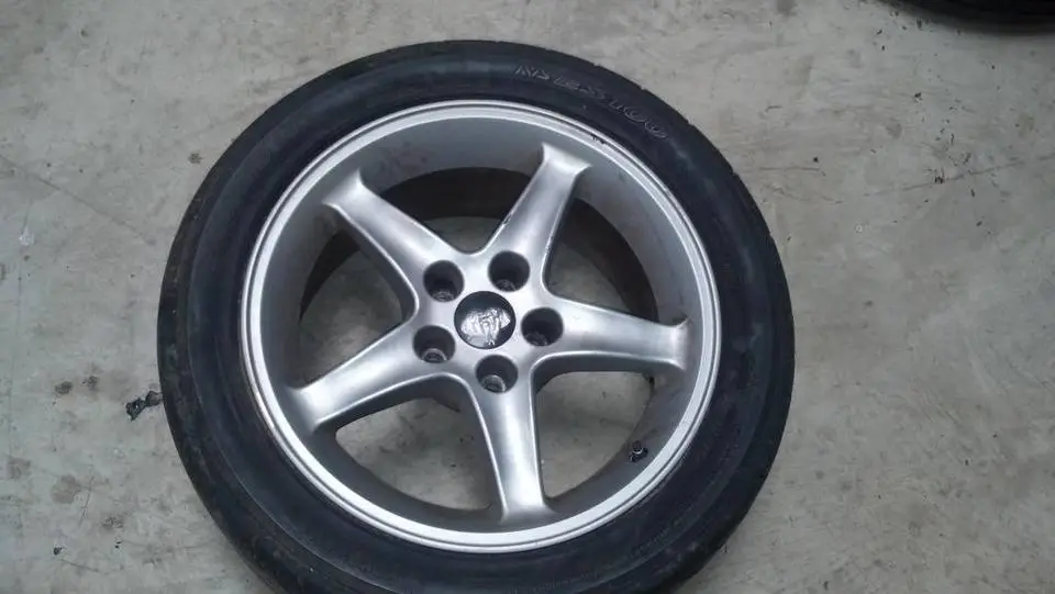

Ok so heres a picture of the rims i did confirm that they are 17x9 with 275's on them already now the question is is 245 to small i checked tire rack and they say a 245 will fit between a 7-9 inch wide wheel but i feel thats a little stretched
Those are aftermarket 1995 Cobra Rs
Proper tire size is 275/40/17
But up front might be tight. You can run a 245/45/17 or 255/45/17 if you wish
