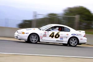

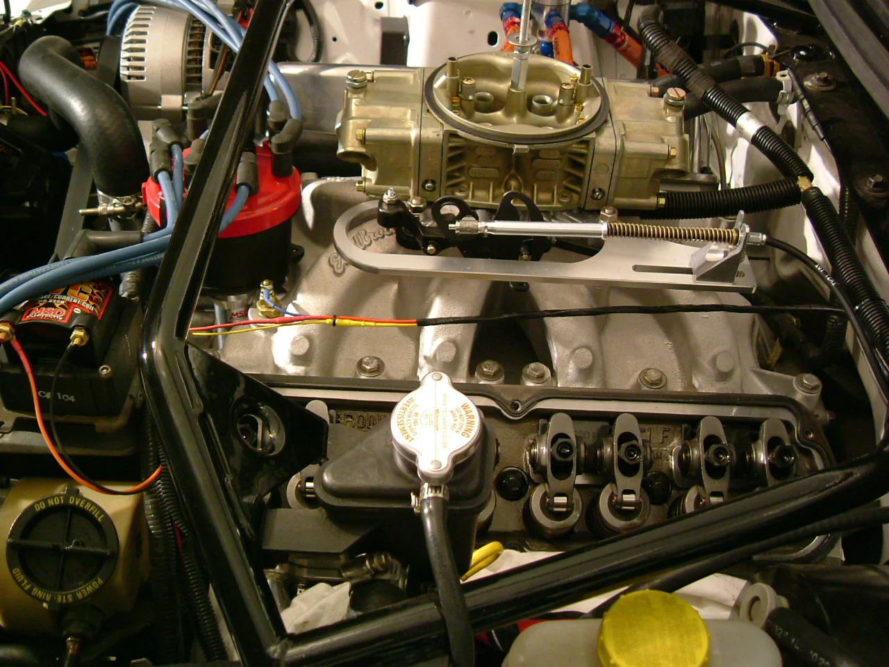

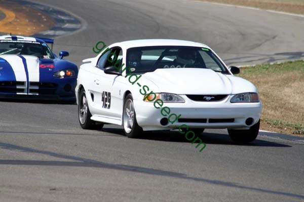

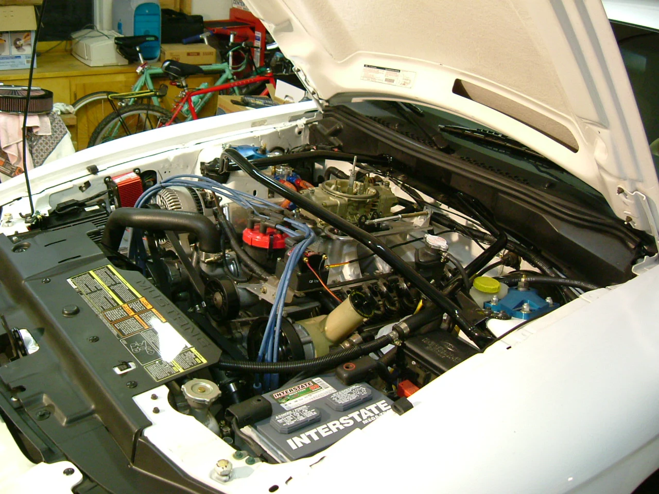

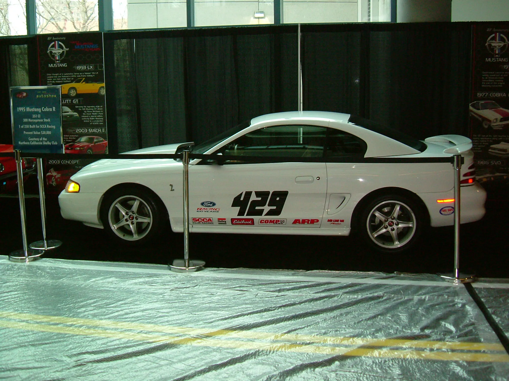

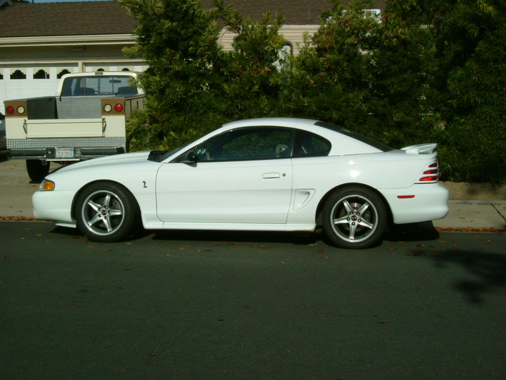

Sorry I just don't have many good pictures of this car. There's one of the #46 Priestley car as well. The one with the pickup truck behind it was taken right after I got the car and had no modifications yet. The one with the factory race Viper behind it was taken at Thunderhill Raceway. The #46 car is me in the Priestley car at Laguna Seca. The engine compartment pics were taken as the car was being finished (yes, it's carbureted now) . The last one was taken at the San Jose International Car Show. I know I have more pictures somewhere, I just need to find them.

Kinda a long story. I tried and tried to get the stock EFI to work, even with custom tuning. At first I tried having the stock manifold extrude honed and it worked OK, but if you think about it, that upper manifold was designed for a 240hp 302 motor with a new lower for the 351. It just couldn't flow the kind of air a 600hp 429 needs. I tried an Edelbrock Victor EFI manifold with a Fox body throttle body without the elbow adapter (I used a rubber elbow to connect to the MAF sensor and air cleaner). By that time I already had the custom 1-7/8" long tube equal length headers on it which placed the O2 sensor too far from the exhaust valves (in the merge collectors) so they were always too cold which the computer interpreted as a rich condition. Whenever the throttle body was at anything but WOT it ran way too lean. The gas pedal was like a light switch. Once the computer transitioned from closed circuit to open loop it went like a bat out of hell.
I finally decided to put a Victor Junior carb manifold and an 830 CFM Holley 4150HP Race carb on it and it has run great right out of the box ever since with no jetting changes. The only change I made was to put a bigger accelerator pump cam on it to resolve a lean just off idle stumbling issue.
I would like to fuel inject it again, but that will be a while since it runs pretty good the way it is, but without a choke it is very cold blooded. If I do I'll use a Victor Junior carb manifold with injector bungs or maybe one of those 4150 style throttle body 8 injector thingies. The great thing about the carb is that it works good and makes lots of power (because the engine now gets plenty of fuel and air).
