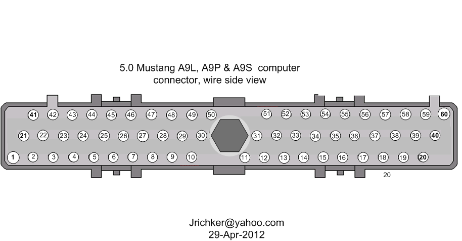

Computer wiring harness connector, wire side
Computer wiring harness connector, computer side

89-90 Model cars: Measure the MAF output at pins C & D on the MAF connector (dark blue/orange and tan/light blue) or at pins 50 & 9 on the computer. Be sure to measure the sensor output by measuring across the pins and not between the pins and ground.
91-95 Model cars: Measure the MAF output at pins C & D on the MAF connector light blue/red and tan/light blue) or at pins 50 & 9 on the computer. Be sure to measure the sensor output by measuring across the pins and not between the pins and ground.

Check the resistance of the MAF signal wiring. Pin D on the MAF and pin 50 on the computer (dark blue/orange wire) should be less than 2 ohms. Pin C on the MAF and pin 9 on the computer (tan/light blue wire) should be less than 2 ohms.
There should be a minimum of 10K ohms between either pin C or D on the MAF wiring connector and pins A or B. Make your measurement with the MAF disconnected from the wiring harness.

The MAF voltages are never measured to ground.
To do it right, the proper way is to put one meter lead on pin C and the other meter lead on pin D; it is not polarity sensitive with a good meter.
If you make the measurements inside the car at the computer, use pin 9 and 50. it is not polarity sensitive with a good meter.
Again, do not measure from either pin to ground.
