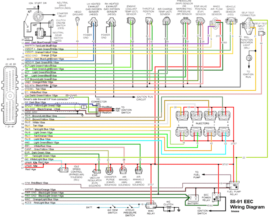

I am having a pesky code 67 and it is keeping me from running any KOER tests. What wires can I hook up to get rid of it? I have a 90 2.3 auto car that was converted to a 5.0 auto, so the trans harness plugged right into the trans, I didnt do anything weird there. However, I did notice that there were a couple wires in the tranny tunnel that appeared to have been cut off at the factory or something, they were right in the grommet. :shrug: But I never had that code with the 2.3 engine harness so I think the 5.0 engine harness is the problem. What should I do?

Try grounding pin 30 on the computer. From the diagram, it appears that it is safe to do so.
If that does not change the code 67, make sure that pin 30 is not grounded. Without any grounds,
it will have 5 volts on the wire.
See the following website for some help from Tmoss (diagram designer) & Stang&2Birds (website host) for help on 88-95 wiring http://www.veryuseful.com/mustang/tech/engine/ Everyone should bookmark this site.
