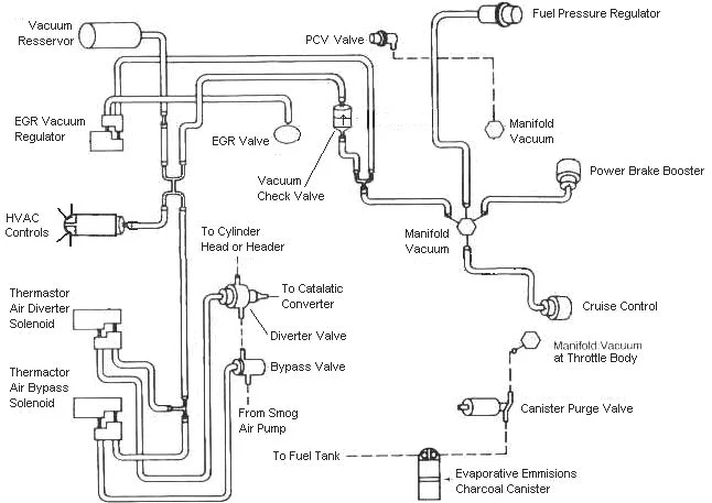

See the following website for some help from Tmoss (diagram designer) & Stang&2Birds (website host) for help on 88-95 wiring http://www.veryuseful.com/mustang/tech/engine/
the dotted line going to the fuel tank...doesn't specify if it's a tube that could be confused with a vacuum line! Does anyone know if that dotted line goes through the passenger fendwell?
I'm very greatful for the help so far, but I need a "real life" description of this canister connection to the fuel tank...and the location. is it a black plastic tube the size of a vacuum line going into the fenderwell on the passenger side?
