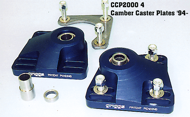

Paul....Been running these Griggs for 3 years now....MM says the Alum NFG???
Umm those aren't Griggs CC plates. These are:
And quite frankly, unless they're some BIG-ASS-BEEFY aluminum plates, I'd stick with steel. Probably THE most important thing to remember when swapping to coilovers is that the entire weight of the car is placed at the top of the strut/shock mount. This isn't as big of a concern at the rear due to the smaller area (which allows less flex) and the lower weight.
At the front however, it's a different story. Consider the average frontend of a mustang is around 2000# plus and you're putting all that weight on the CC plates. This is why quality 4-bolt cc plates is absolutely critical on our cars.
Case in point - I recall some bugwit (ahem, I'm sorry, an individual who didn't do the research and bought "no-name" coilovers from a company who hadn't the technical expertise to recomend good aftermarket CC plates) who installed coilovers in the front. He then dropped the hydraulic jack way too fast for any situation, much less for a fresh suspension install. I believe he learned a quick lesson in the importance of proper research when his struts blew through his 'glass hood, ripping out the rubber in the stock CC plates, and wedging the tires up in the wheelwells. Albeit, an expensive lesson.

They say Griggs on em???..but they sure as hell don't look like those....Guess that will be on the list... :bang: That would be a hard lesson to learn...and also pork my new hood pretty decently... :(
