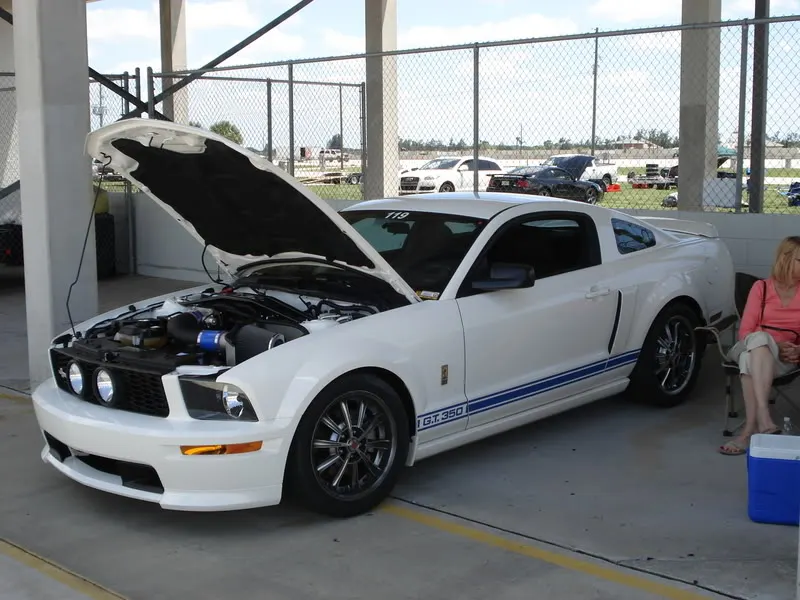

OK Here's the mission.
Weekend at Camp Steeda with the SVTOA at Sebring International Raceway.
3.7 mile Road Course, high speeds on the straights (I saw 125 M.P.H.+) so this will be killer on the brakes what to do, what to do.....
Be able to go all out (for me anyway) all weekend and not worry about stopping. Don't want to ditch the wheels and tires (Shelby CS66's and Nitto NT-555's) to put on bigger brakes.
So what to do.............

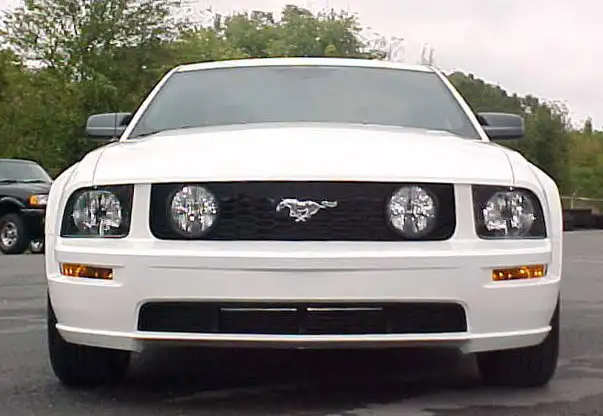

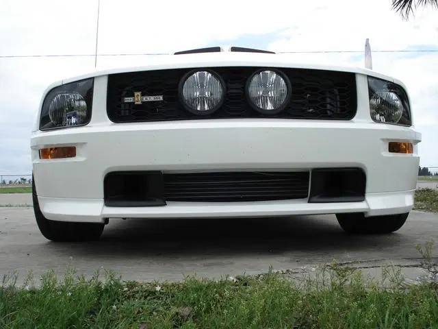

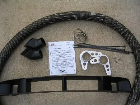

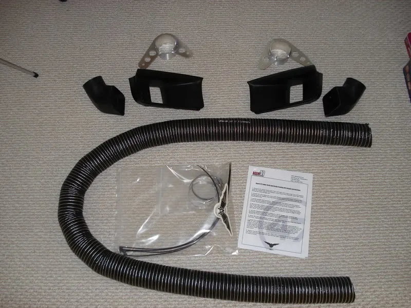

So this is what I got....

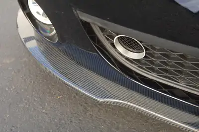

There is also a template so you can cut a hole in the lower part of the fascia.
This is behind the two lower fake black grills so if you later remove the kit you can reinstall the two lower pieces and not see the holes.

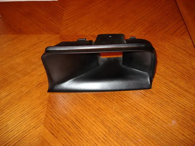

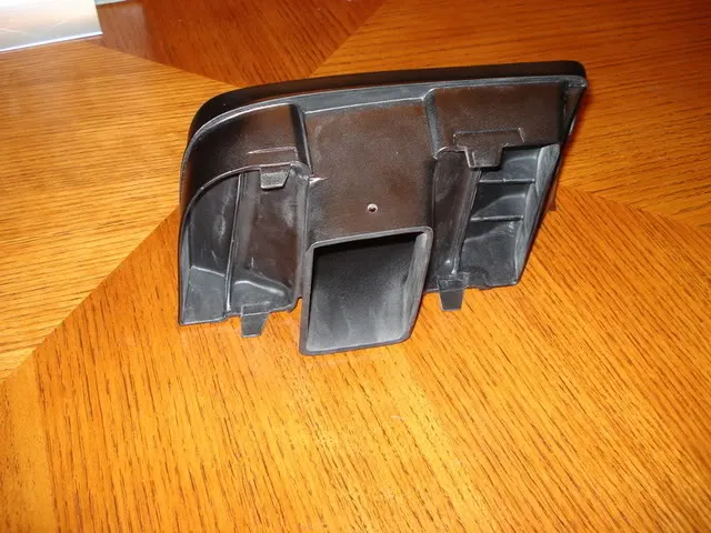

Here's a close-up of the scoops (flash highlighted dust which wiped off revealing a very nice matte black)
Note tabs which use the factory mounting points.

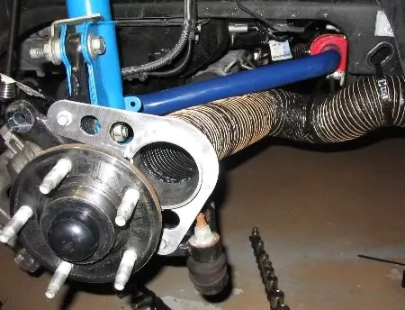

After install, a couple of hours, wheels, rotors/calipers and dust shield have to be removed to install kit...... can be done in your garage with basic hand tools.......I did it.......jacks and stands are required.......
Note: You don't see the white like you see in this photo, it's just because of the angle I took the picture.

Man that looks slick! Besides cutting a hole in the fascia do you need to cut anything else to get the tubing into the right place. And how is the air duct secured to the vehicle? I have been considering getting a setup like this, but have not been able to get much info on the installation and all of what is required to do to your car. I really do not like cutting into a perfectly good mustang.
If you have a stock front GT fascia you did not need to cut anything (I HAVE THE SHELBY GT/CALIFORNIA SPECIAL FRONT END SO I HAD TO CUT), remove your lower stock grill and you will see Ford put two rectangle holes in the grill. Just replace the stock piece with the Agent 47 piece.
look at the next photo and you will see the Agent 47 lower grill will go into the stock opening and the scoops will then go throught the fasica. This part also has tabs that use the Ford mounting points......

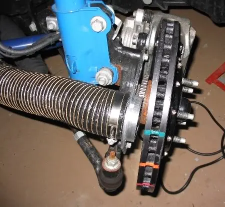

the two "elbows" see above bolt to the lower grill all you have to do is cut the hose in half and mount (this in not a cheap plastic hose but a high temp hose with stainless steel wire in the coil)
the hose conects to the hose brackets where the factory dust shield was (see below)
Look in the below photo and you will see a couple of zip ties locate the hose so it does not move the hose is conected to the lower grill the a stainlees steel hose clamp as is the peice of hose on the rotor side. Trust me it works....
