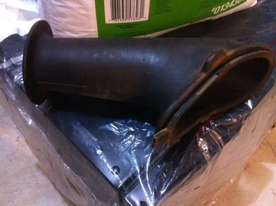

Consider just removing the inlet snorkel/silencer from the airbox in place of buying a CAI:

As long as it isn't one of those tine little filters.
Normally improvements are seen with a smoother pipe with less bends or heat transfer and or a bigger filter of the same filter level or just a filter that filters less. I Just use a different tube from a cheapo ebay CAI and attached it to stock air box silencer removed. I may try a large KN short ram one day if I get bored...All I know is the little filter going into the fender to me felt slower than stock.
