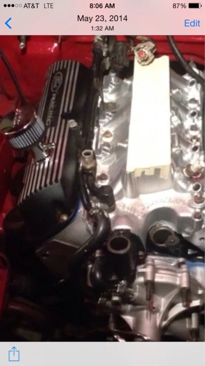

located in the heater tube that runs to the heater core right in the front . Takes 2 mins to change
That's the sensor
