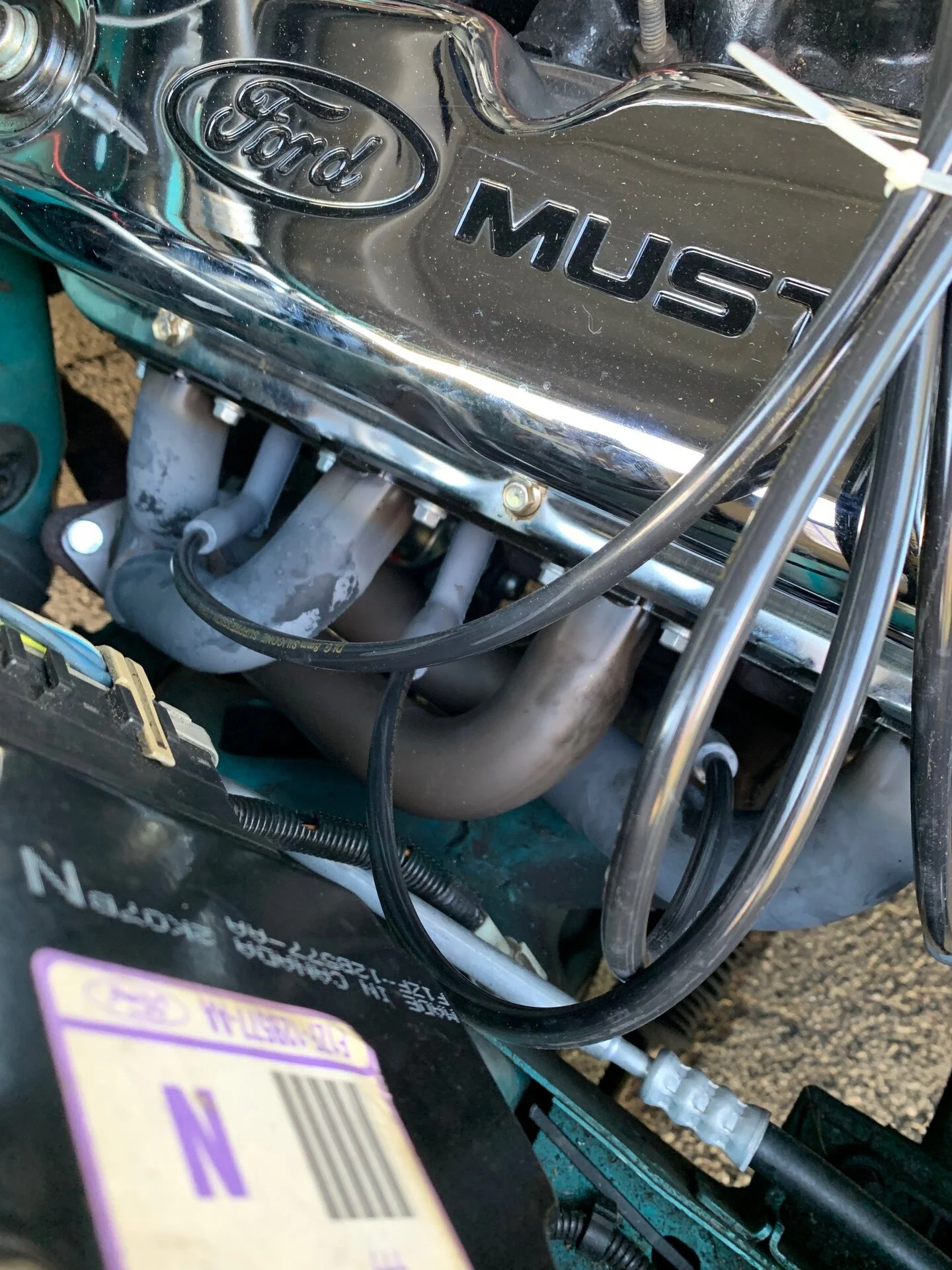

After installing aftermarket headers, I noticed all the primaries have a consistent heat pattern except cylinder #2. Checking the temps confirmed cylinder 2 is around 50 degrees cooler at idle. I cannot check the compression because of the stupid GT40p plug location, but I highly doubt its a compression issue. The engine only has a few thousand miles on it and it idles too well. I don't think its a fuel issue since its carbureted. Ignition system was new with the rebuild, and plug wires are in great shape. The spark plug looks great and is gapped appropriately.
There is a tick near this cylinder so I'm wondering if a lifter is going out, although I am not sure how that would cause a temperature difference. I can't wiggle the rocker and the stud it torqued at 20lb.

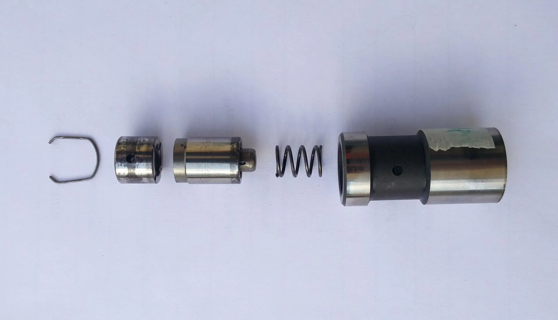

A header leak can sound like a ticking. 50 degrees difference does not seem like much for a dead cylinder. I’d hate to see you take apart the top end for something simpler.although the lifter cup clip is not right.
I wonder if the lifter is causing the valve to either bleed compression or prevent it from opening all the way... That would cause a cooler cylinder. I know the valve moves and makes compression to a point. I can't hear an difference in compression while cranking and I can see the rocker moving with the valve cover off. Also no way to do a compression test unless I remove the header... I might go ahead and pull the lifter when I get a chance and see whats up.
I think at this point, it's your call as to what route to take. I definitely see an issue with that cylinder just based on the appearance of the header alone. As to what to do next, it's all a PITA no matter what. Pull header or pull lower intake.
For me, i need to verify the problem first before fixing it and for me, that means doing the compression test. At least your header hardware looks new, so it wouldn't be too bad to pull that off and check.
