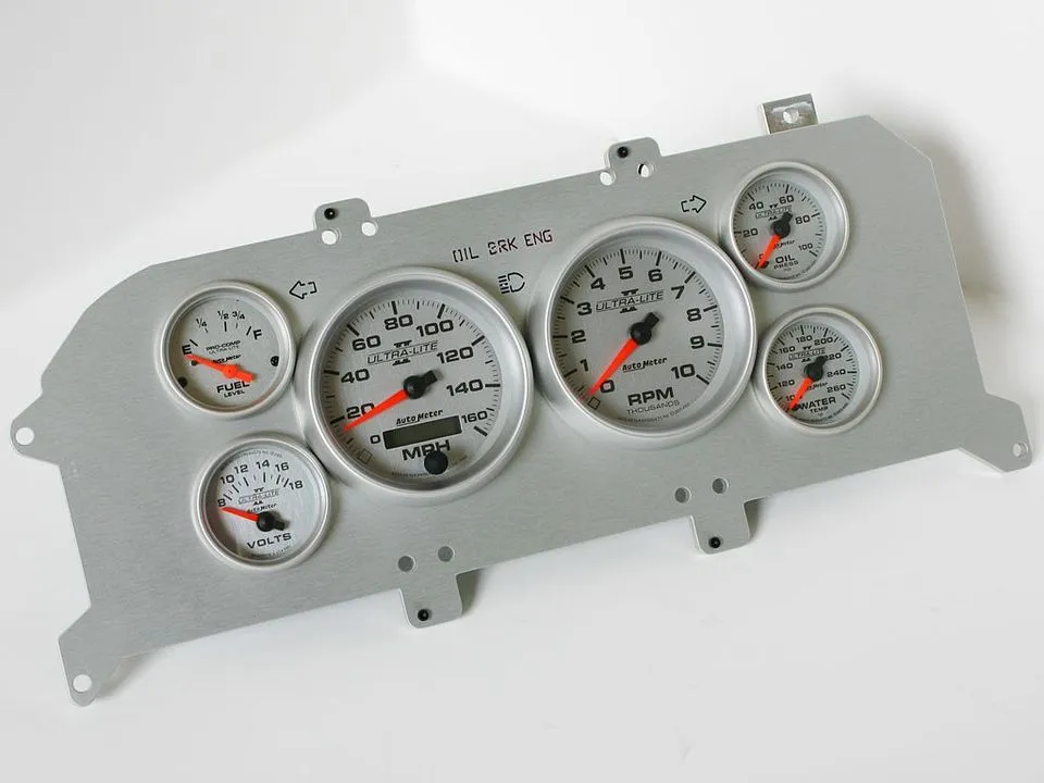

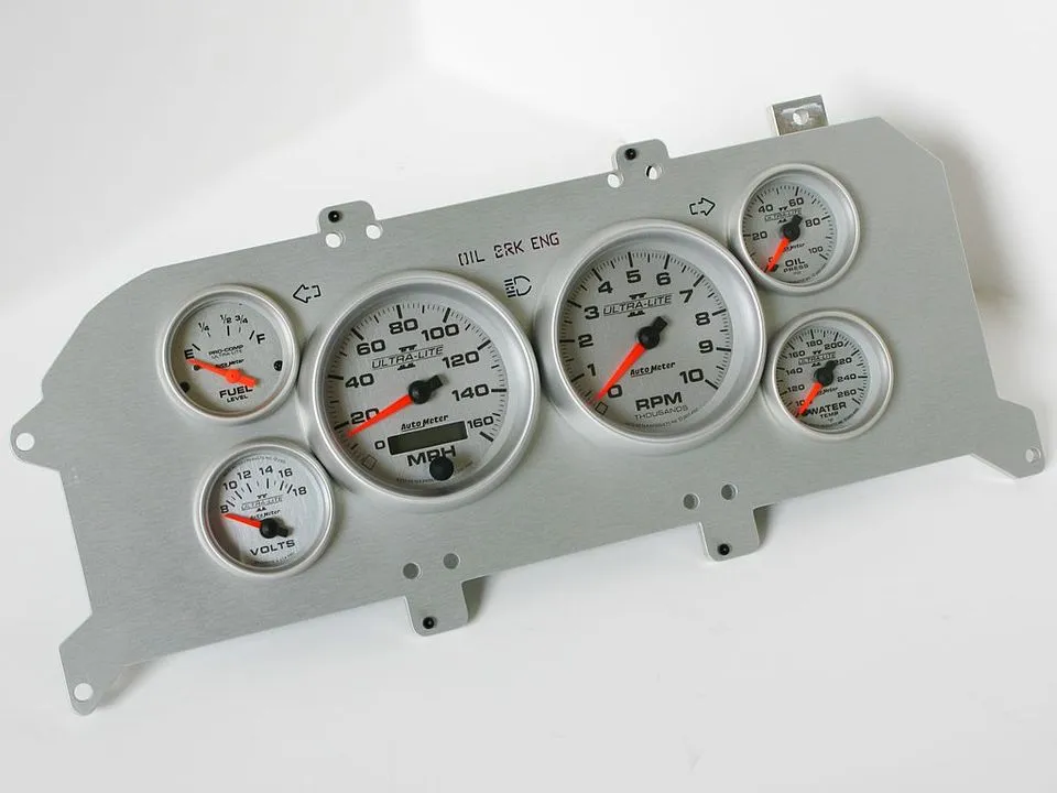

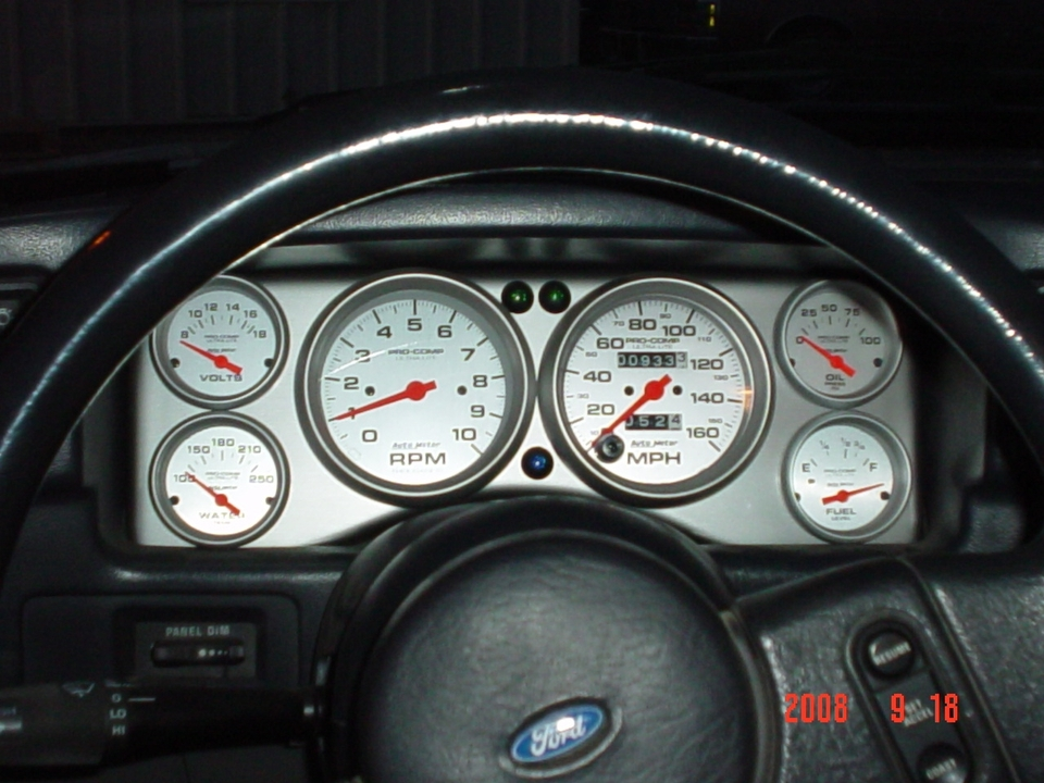

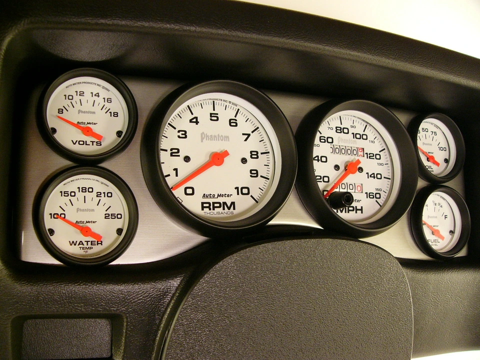

The MC-Machine looks more finished, the turn signals/high beams/etc look cleaner, but I've heard there may be some trimming needed using this one:
The florida 5.0 kit pull the gauges out a little further, but I don't love the LED indicator lights.
